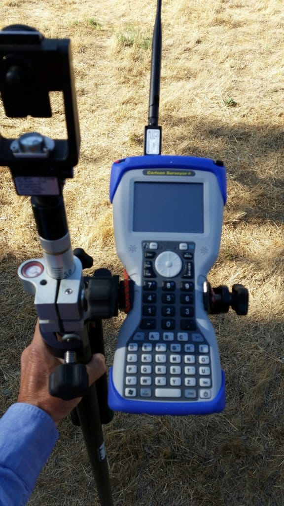

I had no trouble pairing the Parani with the native Surveyor+ BT, I just couldn't get any useful range out of it. In desperate straights, I kludged a temporary solution in order to get some work done, bolting the Parani directly to the COM1 port:

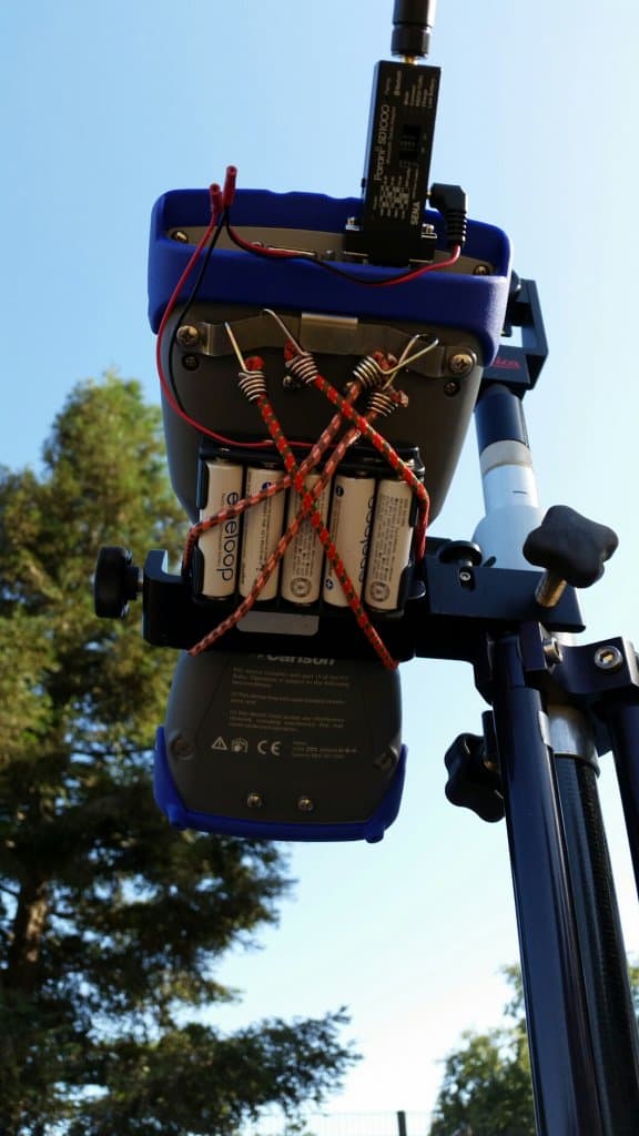

That wasn't so bad, although it's a fragile setup and definitely will be altered when I get parts and time. What really makes it an ugly rig is the power solution:
Eventually I'll run the radio off the COM port, which has +5v on pin 4 according to Juniper documentation. But for now it's AA bats and bungee cords.
