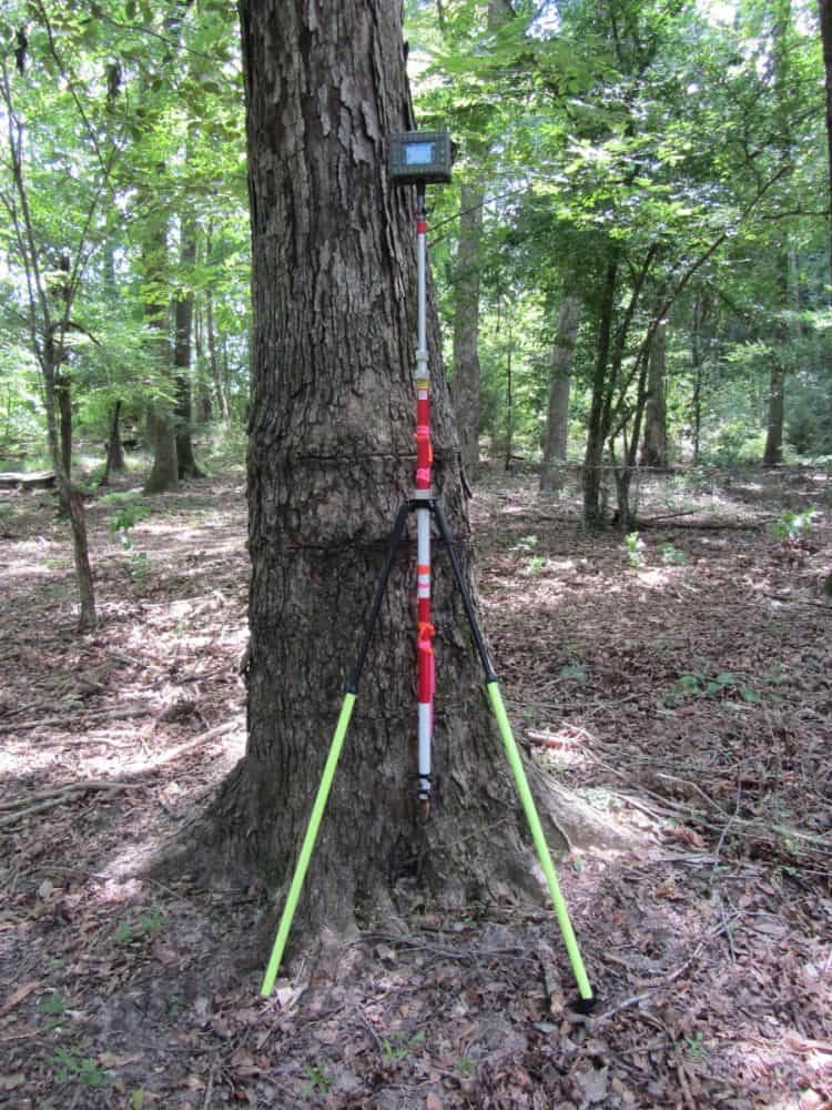

This pic, was taken of the LS sitting on a rebar. It is about 14" from that big oak. It ran up 10 groups, (Shawn calls them Buckets of coords) and threw the shot out 3 times, before it finally stored it. Took some 34 mins on this point. It was not a critical shot, and I was still trying to get oriented on this job. So, I thought I'd try this. I also have a 34 minute static shot here too, so I compared them. (These are run simultaneously, so total time is 34 mins. Differences are: N +0.012' E -.026' Elev +.037. All those differences are holding the Static shot, and comparing to RTK.
Some patience is in order, if you go as I have done, "off in the bad stuff".

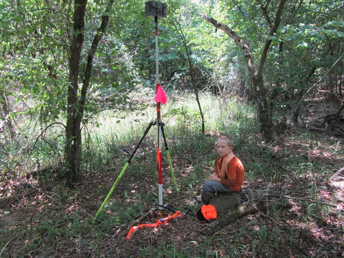

Now, on this shot, I have my 5 yr old with me. He is a blast to work with . I had a few corners to set, and he wanted to go. I often set a rock pile around my corners. I had walked to the local creek, and got a large semi square stone, and while waiting on the GPS, Set it beside the point, to be moved to beside the corner, before I left. I set it down, and 5 yr old said "Thanks dad, now I have a seat". It made my day. Like as though I had gone to the creek bed, and hauled that 50-60 Lb rock over there, so he could have a seat!!
Now, I hope everyone has a good day. And, I hope my story helps some who don't understand what I'm doing, to understand.

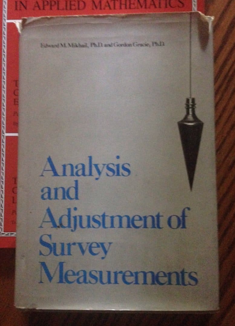

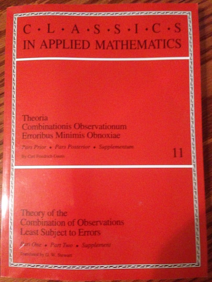

So, that's my little story. I have had several curious about "how I got this way", and one wondered what book to buy. To myknowledge, there is no book on how to ABUSE GPS, and win.
Here's a new book of text that a few centuries old It is a English-German edition. So you could learn some German too and be a real ÌÏber Surveyor. If you want to buy it, I'll send it to you.
Posted : July 21, 2016 6:05 pm
Well, How much do you want for it? And, have you read it?
Least Squares is interesting.
Posted : July 21, 2016 6:21 pm
Nate The Surveyor, post: 382008, member: 291 wrote: Well, How much do you want for it? And, have you read it?
I was thinking Gauss and German was stuck in my head.
This is the Latin-English edition.
I guess he wrote in Latin
Posted : July 21, 2016 6:51 pm
OK, I read a LITTLE Latin (et al) but not enough to try to comprehend a technical work, at any productive rate....
And, I know a little Greek. He owns a restaurant in Chicago.... 🙂
And, a Jewish guy... owns a clothing store!
Posted : July 21, 2016 6:57 pm
Nate The Surveyor, post: 382010, member: 291 wrote: OK, I read a LITTLE Latin (et al) but not enough to try to comprehend a technical work, at any productive rate....
It's in English and Latin
It's still used as a text for Applied Mathematics since it is the inception of least squares in 1656.
Posted : July 21, 2016 7:13 pm
It may be that I need a less rigorous book to start with.... I found one of those on Amazon for 25.00 I have played with expanding error ellipses, and traverses, with maximum errors, and average error potential. It was kind of like deliberately building a cabinet sloppy, and then playing with the slop, or looseness of the joints. That is one thing I like about GPS. Error from one base station does not propagate, in the same fashion that it does with a multiple leg Total Station Traverse. Have you read it? How easy to comprehend is it?
Posted : July 21, 2016 7:28 pm

You raised it to 10ft. and stored a shot? How? I am curious because this was a major concern of mine considering the combined receiver/data collector. Thanks!

Jason Graves, post: 382074, member: 9531 wrote: You raised it to 10ft. and stored a shot? How? I am curious because this was a major concern of mine considering the combined receiver/data collector. Thanks!
Well, there are several ways to do this.
My common way is to set the settings to "Boundary", and then press START. Then, elevate it. If it manages to grab a click or two, before it gets up there, it is ok. It will abandon those point groups, because they won't fit the accuracy pattern.
Then, it has a light on the bottom. This light flashes, with every Epoch. Then, it has a pattern it goes into after it gets the shot. So, you can strictly do it visually.
Another way, is to turn on the MIFI on the cell phone, and completely control it from your Android based device, or I-phone. The down side of this, is it does drain the batteries in the cell phone a bit faster. I have a backup power source for the cell phone. Another minor down side, is there is a little delay between the two.
Another way, is to put a time delay in it, of 10", or so.
One word here, is versatility. There are usually 2 or 4 ways to accomplish a given task.
Another way to do it, is with a WIRE and an external antenna. This would be a good way to go, with a Side by Side UTV. Mount the external antenna, on the UTV, with a wire, and a small cradle for the LS.
Versatility is a BIG part of the LS.
Why do I like it? It does things that NO OTHER device can do. I have run MILES and MILES of traverse, with Transit, and tape. And, with Thedodolite, and EDM. And, with Total Station. I held a funeral service, for my fine traversing skills, the other day! There is a ROMANCE with doing GOOD Total station work.
I was concerned about that item too, when I bought it.
I'd prefer a VERY light GPS antenna, that bluetooths the signal to the Data collector, and processor.
But, I don't think that can be done... yet!
Posted : July 22, 2016 8:54 pm
