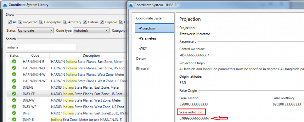

The grid does not really have an elevation per se. The grid "touches" the surface of the ellipsoid at two line of longitude. This is controlled by establishing a scale factor on the central meridian. In both Indiana zones the SF on the CM is set at 1:30,000.
Distances should be reduced to the GRS80 ellipsoid (elevation factor, depends on ellipsoidal elevation or orthometric height plus geoid separation) and then to the grid surface (grid factor, depends on location, mainly longitude).

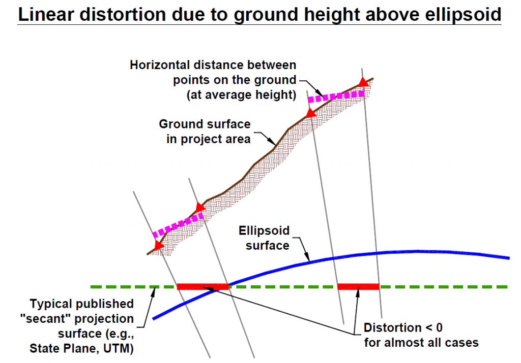

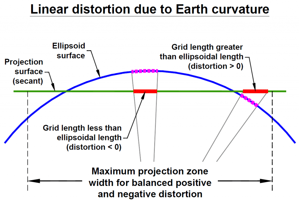

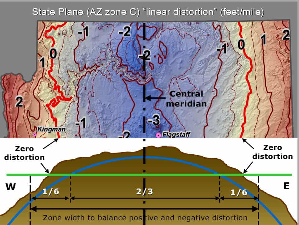

Can I retract what I said? I was wrong. Grid coordinates are projected perpendicular to the Ellipsoid.
Here's a couple of good graphics lifted from http://www.oregon.gov/ODOT/HWY/GEOMETRONICS/docs/ldp_workshop/2_low_distortion_projections_ground_truth_v9-michael_dennis.pdf&apos ;">Michael Dennis's excellent white paper:
Dave
