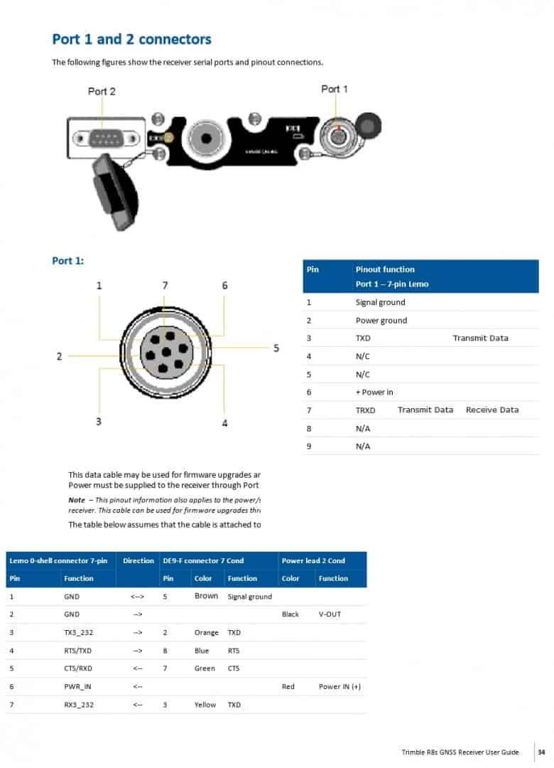

For the antenna You need a TNC (not RP-TNC) male/female extension lead.
Like these https://www.rfshop.com.au/coaxial-cable-assemblies/with-tnc/tnc-extension-cables.html
For the power, you can supply 12V or 24v external power into port 1 (7 pin lemo) using a trimble cable or probably from an alternative supplier.

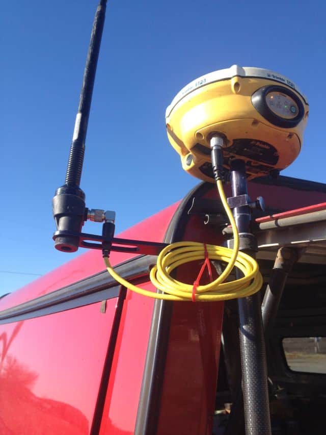

I use an external antenna quite often.
This way is very portable. I have also used a longer coax and put the antenna on top of a level rod.
Only problem is, this antenna bracket came in a conex box that my boss bought at an auction with a bunch of tripods and poles so I have no idea where to get one just like it.

Here is the bracket:
http://www.allenprecision.com/index.php/catalog/product/view/id/4863/s/seco-radio-antenna-bracket/?gclid=CNid9PLy9tECFZS6wAoddbcD3Q
The antenna mount it a Geospace 11581 (the black plastic molded piece between the antenna and the coax)
For UHF, (450-470) the coax is a typical cable with tnc connectors.

JaRo, post: 412430, member: 292 wrote: I use an external antenna quite often.
Nice Setup. Are you sure though that an antenna is compatible with my R8-S model internal radio?
BTW that unit looks way too slant. Are you measuring using that position

jaro
 jaro
(@jaro)
Posts: 1722
therock003, post: 413332, member: 12282 wrote: BTW that unit looks way too slant. Are you measuring using that position
Well no, it is leaning against my truck so I can get a picture.
James

therock003, post: 413403, member: 12282 wrote: Thanx guys, but budget is running low and i find 100+ to be expensive. Can i make my own somehow? Looking for some diagrams to make sense of it somehow
The pin outs for the lemo are in the manual. So you could buy a lemo plug and wire it to crocodile clips (or whatever you need for the battery you will be using). Tnc extension cable for the antenna can also be bought fairly cheaply.
Posted : February 11, 2017 3:08 am
squowse
(@squowse)
Posts: 998
https://www.manualslib.com/manual/828648/Trimble-Trimble-R8.html?TB_iframe=true&page=49
Make sure you know which way you are looking at it. The diagram is viewed behind the plug. As far as I know you can't buy lemo plugs prewired unless you find an old kead on ebay. The Leica ones are similar but different in my experience.

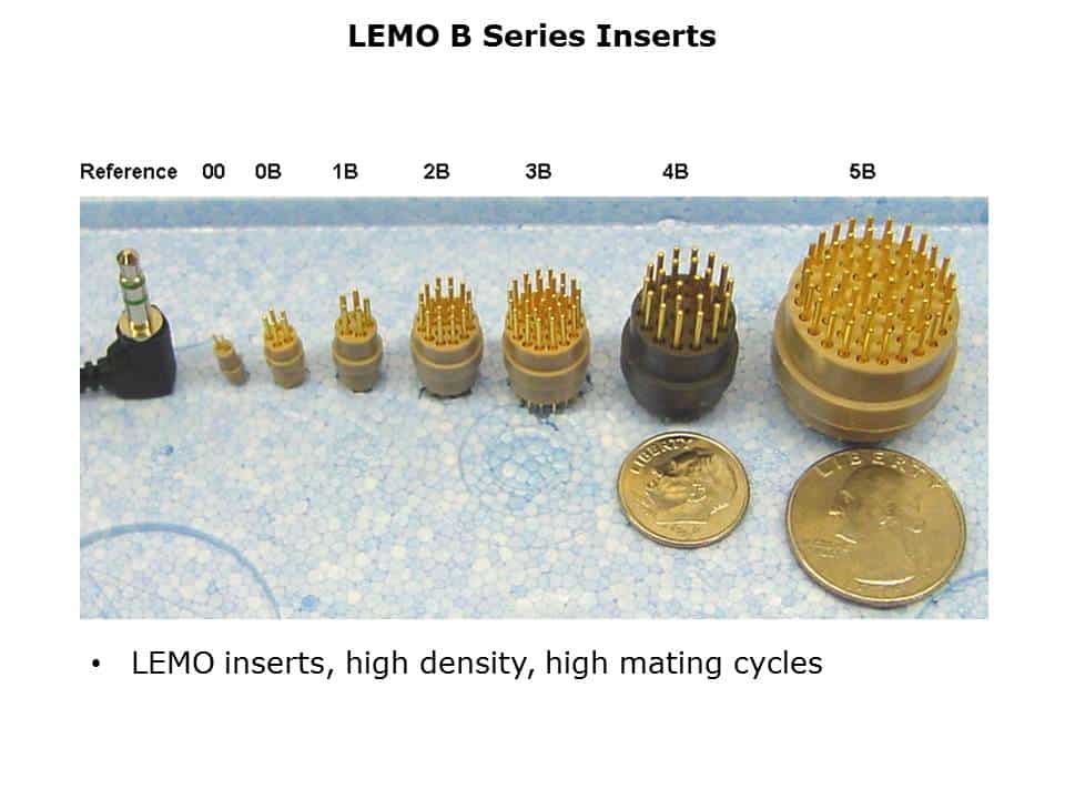

therock003
(@therock003)
Posts: 189
I think this is the correct connector but how can i make sure before i order. I dont see anywhere in the manual the connector size whether its 0B/1B/2B.
http://www.digikey.com/product-detail/en/lemo/FGG.1B.307.CLAD52Z/1124-1064-ND/2786166
