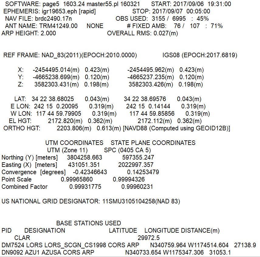

I'm trying to do an OPUS-Share on a triangulation station (EV9284) that was placed in 1978. Since then, what was probably a Pine sapling at the time has grown to a tree about 50' in height, 23 feet south of the station, with some limbs overhanging the station. I was able to trim the reachable limbs, but I didn't have a pole saw to get the higher ones. I occupied the station with a Trimble 5700/Zephyr Geodetic for about 4 1/2 hours.
The results were surprisingly sucktastic, with my Lat error being 0.043 meters and the Long error reaching 0.319 meters. I understand OPUS will not accept it as a share if the Lat/Long exceeds 4 cm, so my Long really screws me.

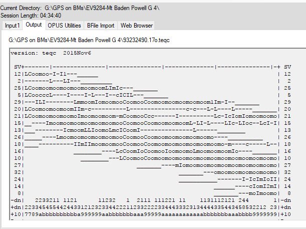

I pulled it up in WinTEQC and looked at the QC for the observation and it stinks as expected. I'm still figuring out TEQC but the best I can see to do is to remove the really crappy SVs. I'm not seeing a way to perhaps edit out periods when a specific SV is bad, but keep the rest of its record. Is this possible in TEQC? Or should I just give up on it and move on?

The percent observations used is only 45% with 71% of the ambiguities fixed. Values that low indicate that there is not much you can do to improve things. My only suggestion is to select other nearby CORS stations for additional OPUS solutions.

The OPUS extended output includes a section (see linked image) that provides data regarding each SV. It can be used to see whether any SV data should be excluded. That said, the OPUS processor would most likely exclude bad data when performing its solution. It does attempt to use as much data as possible.
But the real advice, IMO, is to forget this site. Your observations show, yet again, that bad sites yield bad solutions. I am not familiar with modern commercial processing packages. Old versions of the Trimble SW included planning software allowing you to enter masks where obstructions existed and I believe show you the resulting reduction in DOP values.

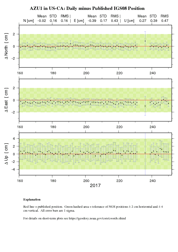

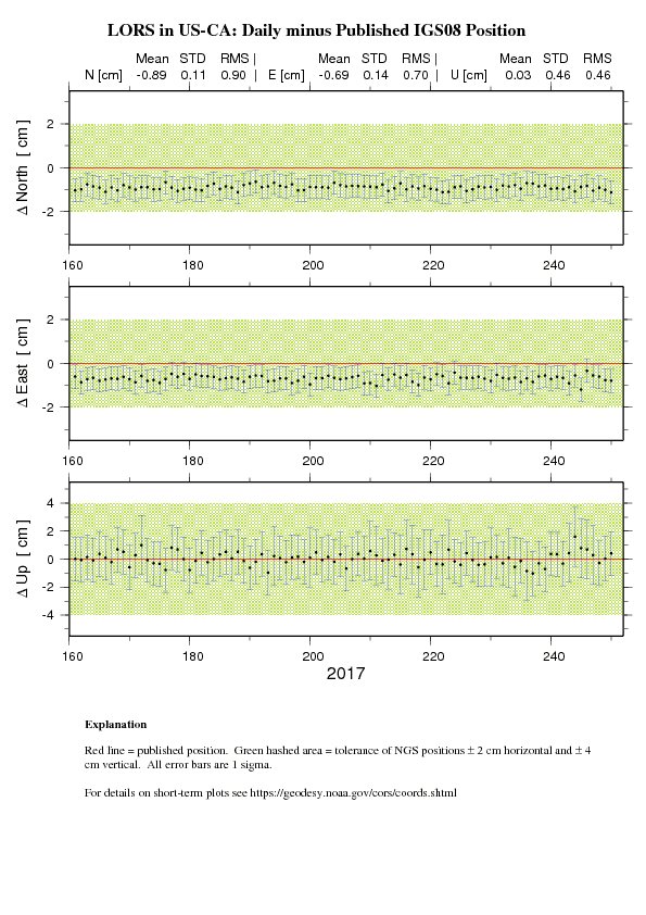

What Loyal is talking about is to look at the short-term time series plots for the CORS stations used by OPUS. For example, here are the 90-day plots for LORS and AZU1. Your OP shows "CLAR" as a base station, but NGS doesn't recognize it as a valid CORS station.
You can see the latest plots by going here https://www.ngs.noaa.gov/CORS/ and entering the CORS station name, and clicking on Time Series (short-term). They can indicate problems with a particular CORS station. For example, there is a data gap and one poor solution for AZU1 between Julian day 232 and 238.

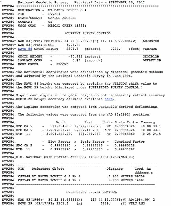

As can be seen from the data sheet, the published elevation is by VERT ANG (vertical angle) in NGVD29 and transformed to NAVD88 via VERTCON. As such it is not useful in the GPS on BM campaign. It is NOT a BM and as BushAxe says, why submit bad data?
Look at your peak-to-peak difference in the ellipsoid height. It is 3.6 DECIMETERS!
Looking at your OPUS result (2203.8 m ) and the VERT ANG based height ( 2204.6 m ) we have a better check than I would have thought. Still it is an eight decimeter difference. "Better" because I would expect the VERT ANG based height to not be as good.
