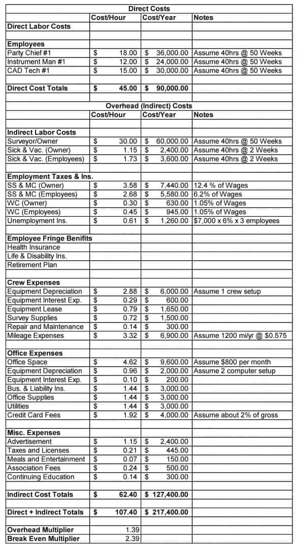

OK, here is my first stab at modeling a typical small survey office with one 2-man crew and one CAD tech in my area. I did the best with making my numbers as realistic as possible based on my own numbers as a solo surveyor and the current going crew and tech rates around here. Some things I took a guess at though. In this scenario, I have the surveyor/owner as 100% overhead. So what do you think? Am I missing any expense categories? Are any of my numbers totally out to lunch?

I am not sure that you should count all your (owner) time as an overhead expense if you expect to have charged hours that would be direct labor. Also, any overhead time (non-chargeable) should be counted as an indirect expense as well. Vacation time, sick time, holidays, payroll that is not chargeable to a client

Are you really only paying your party chief 36k ?
NZ isn't known for high wages, but they are worth around twice that here.

Well... I'm not, but that is the going rate around here plus or minus $2-$3 per hour with sketchy benefits. Yeah, I know it should be better, but those are the realities.

Looks pretty good to me, especially for a first stab at it.

I forgot holiday pay. Typically how many paid holidays do you have? I probably need to factor in payroll services as well. Does anyone know how much that costs? Also, the owner/surveyor should be somewhat billable, but how much (maybe 20%)?

Your numbers are about right, a 2.5 multiplier but you do need to make your self billable. I would use 30% for a working number and try to be 50% or more billable and offload the book keeping and stuff to an outside service. That will give you more time to work on surveys and business development. I think there area 11 government holidays. Use that for your calculations and consider dropping one or two of them.
Posted : November 10, 2015 7:37 pm
I managed a company many years ago that the owner insisted upon keeping the multiplier at or below 1.7 and it really bothered me at the year end evaluations.
His business model kept everything in the stone age with no overhead to acquire better equipment, expect helpers to want to learn more and locked wages so low that it was impossible for any of us to get out of debt.
Making the leap from there to solo was not a hard choice.
After learning of what others make in our industry, 2.5 is not out of the question and that can leave money on the table.
Bottom line is that everyone had a different number because they have different models they want to work under.
Posted : November 10, 2015 10:09 pm

A quick rough check you can do on the result you get - the yearly salary divided by 1000 gives the minimum hourly chargeout rate for a person. If your figure works out under that then you are probably missing something. I'd always account for site expendables as an additional cost on the individual job, since they can vary so much.
Hours worked in a year - base it on 1600, unless you have a full time permanent contract: holidays, bad weather, sicknesses, pointless meetings and general application of Sods Law get rid of the other 400 hours. Same applies to instruments.
