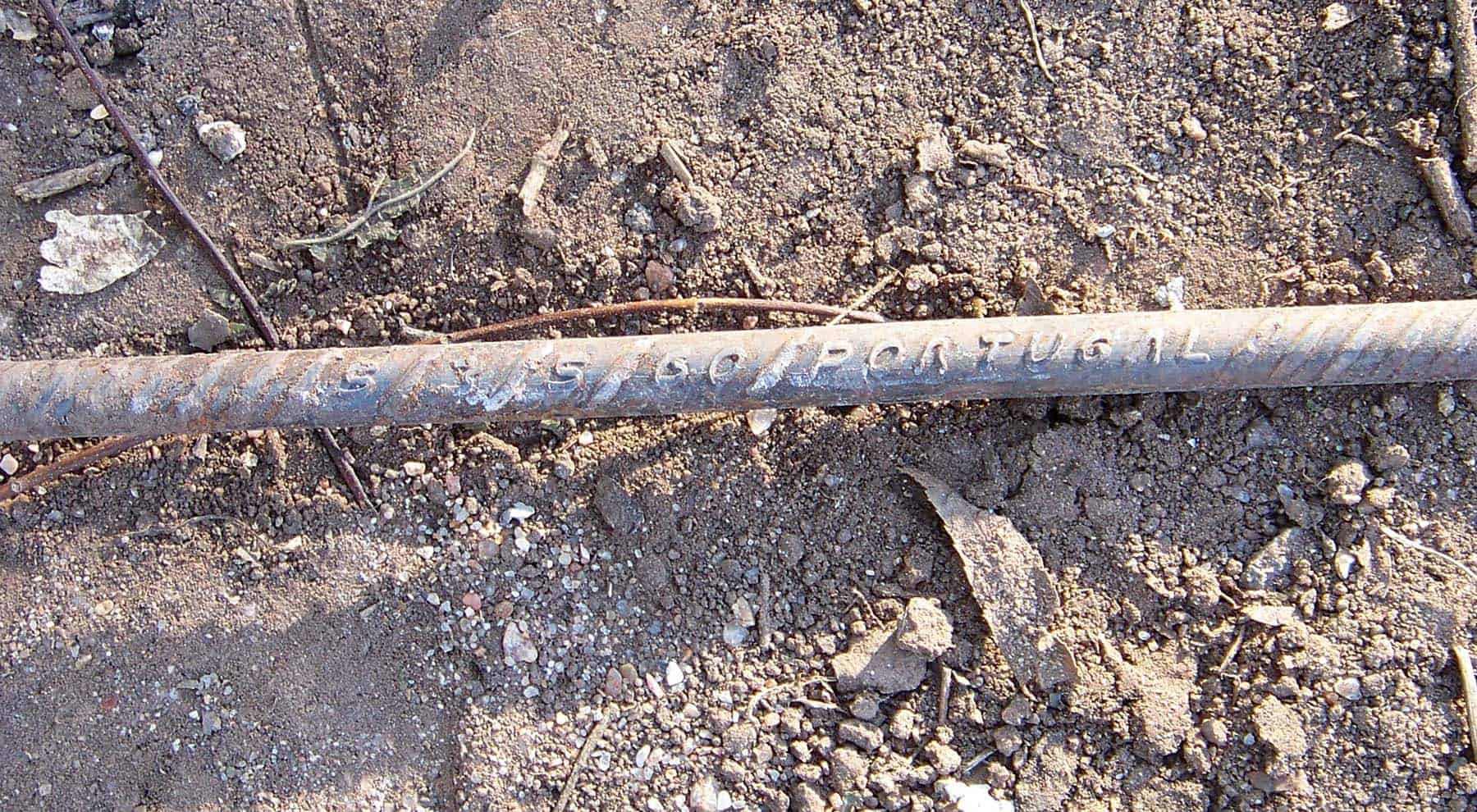

So I'm working on determining where the boundary between two lots is in a subdivision laid out in 1910 in Austin. One of the questions deals with when a particular rebar stake was set. The barest description of the stake would have been "found 3/8 in. rebar 24 in. long, top 10 in. severely bent; removed and straightened the bar and reset it in position of plumb base". However, there are some additional details of the bar that tells when it was set. Yes, the fact that the mill finish hasn't rusted on most of the bar is a clue, but there's more in the mill mark:
Just from the above photo, what would you conclude about when the bar was set?

Quite recently, however, that *may* and *may not* be significant. I have often found MANGLED and hard to work with and rusted (nearly gone) rebar. I have PULLED them out, and RESET a fresh one. However, the NOTE on my plat says "Found bent, mangled ancient rebar, in poor condition" Replaced with 1/2" x 30" rebar, and cap" I have also been known to set a 3/8" rebar, as deep as I can get it, before the 1/2" one passes it up. Usually about a foot down. It's in my notes, but often not published. If you can find a paper trail, that establishes it's pedigree, you are back in the Happy Happy Happy!

Well, the date when the bar was set should answer those questions. Based solely upon the mill mark, when would you say that it was set?

That rebar looks to me like it still has some of the surface finish from the mill. It likely hasn't been in the ground over a year, perhaps much less.

Apart from the state of corrosion - or lack thereof - though, the mill mark itself provides a clue that nails down quite well the year that bar was set. The spacing on the deformations meets the modern ASTM specification, and the "60" means it was rolled out of 60 ksi yield strength steel, grade 60 rather than grade 40, but neither of those narrow the time period very much as to when the bar was set.

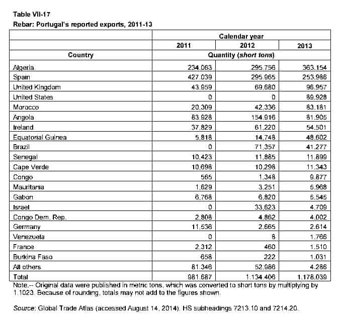

One of the claims is that the above rod was already in place, as if it were an old marker of unknown origin. The problem with that is that rebar has only been imported into the US from Portugal since 2013.

"One of the claims is that the above rod was already in place..." But since the prior surveyor didn't cap it or fully describe it, he/she can claim the Portugal rebar is not what he found....
