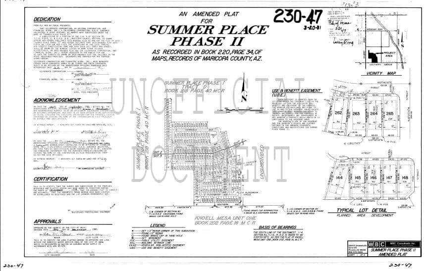

Your thoughts on this would be appreciated. The board that represents this community contacted us to find out where the interior lot lines and the subdivision boundary lines are in relation to their respective concrete block walls. Each lot is separated by cmu walls, the exterior boundary is walled.
The watering of the landscaped area adjacent to the walls has over the years eroded the walls. The homeowners are arguing with the association over whose responsibility it is to fix the walls and want to know where the walls are in relation to the property lines.
I believe that the centerline of the interior walls are built on the property lines and that the walls serve as evidence, typical of subdivisions here. On the exterior boundaries I usually find the pins at outside face of wall. A cc&r has not been made available. I asked about a title report.
Attached is a chapter from Ron Platt's Arizona Surveying and Boundary Law on Party Walls and the cover sheet of the plat.
Again, Your insight would be appreciated, Thanks, Paul

I concur. I believe that the exterior face of the exterior walls now represents the exterior lot lines, and, absent a dispute between nieghbors or court decision to the contrary, the centerline of the interior walls delineates the interior property line location. The walls are the property lines and no survey is required.

Gotta luv dem HOAs.
That plat date looks to be September 1987.
In many states the original bylaws have an end date unless they have been amended, renewed and/or rewritten and adopted again.
That would give the home owners an opportunity to have some ammo on their side.

Seems to me, if there are pins, the lot and boundary lines could easily be established. In 1987 most firms did pretty good work. Why would this become a legal issue for you?
Who should maintain the wall is not a boundary issue.
