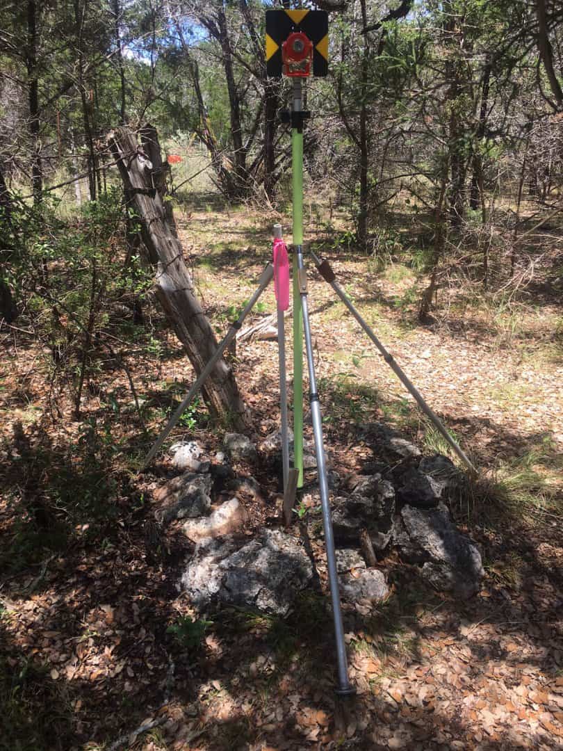

Sad fact, too many surveyors use poorly defined targets. Too many surveyors no longer do angle sets.
That 1" error factors into every pointing in an angle reading. As well as not keeping your prism rods and tribrach in top adjusted shape.
Kent, I guess you forget that you are an anomaly.
Posted : August 3, 2017 11:14 pm
Paul in PA, post: 440060, member: 236 wrote: Sad fact, too many surveyors use poorly defined targets.
Yes, the most fundamental and easy way to upgrade angular accuracy is just to use well-designed targets that are up to the task and use methods that actually center them over the ground marks they are nominally occupying.
