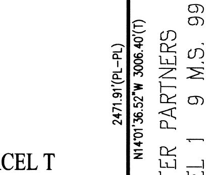

And yet, their curve table only provides delta, radius and length -- no radial or tangent bearings.

Hundredths of a second, eh?

Radial bears seems to be a CA thing unless you are working with a non-tangent curve. Now the hundredth of a second in 3000 feet, that's some good stuff.

Probably didn't change the defaults in their software.

Jim Frame, post: 441882, member: 10 wrote: And yet, their curve table only provides delta, radius and length -- no radial or tangent bearings.
i've seen cad monkeys do crazier things.
what does the"T" stand for? "Tangent" is my only serious guess.

"T" for total?

Though it seems superficial to provide the hundredths of a second, in a world or precision and at the distace given it could make a difference. As far as whose hundreth is closer, this guy definitely believes his is closer.

John Putnam, post: 441890, member: 1188 wrote: Radial bears seems to be a CA thing unless you are working with a non-tangent curve.
This subdivision has non-tangent curves in my area of interest. Fortunately, they were tangent on one end, so I was able to recreate the geometry, but it wasn't convenient.
Posted : August 13, 2017 8:01 pm
Frank Shelton, post: 441897, member: 272 wrote: what does the"T" stand for?
Total, as in overall distance. Unfortunately, they mislabeled some of those as well, showing overalls that don't correspond to the monuments indicated.
