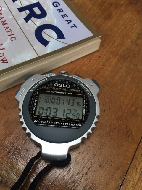

I think a $40 SW will do exactly the same thing for you as a $140 SW. These days we have timing well below 0.1". When I compare a dozen time syncs, with SW to iPhone display and shortwave, the std dev is generally 0.02". Hand-eye delay? Probably. But that would be the same mental time lapse of a star crossing.

Kiss the frozen fingers goodbye. Got a "proper" stopwatch, with 60 split time memory, and nighttime illumination.
Waterproof too. Good thing; we got an inch of wet snow today.:excruciating:
