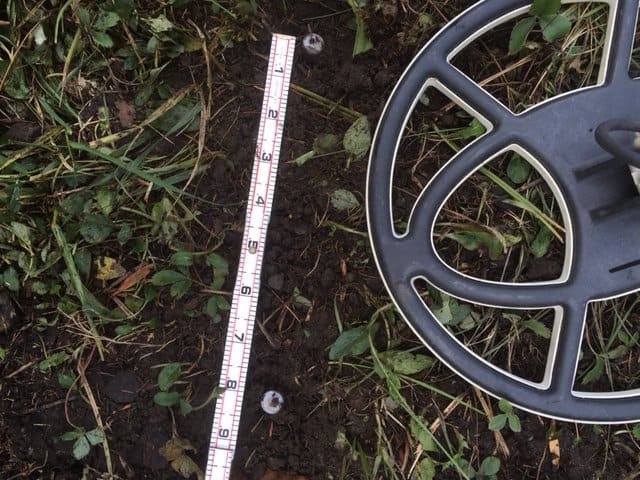

Did number 2 (stake out the point from another known point); borrowed my friend's metal detector (a very nice one), and found the missing point about 8 tenths away.:-)

If you're coming off of a known control network and staking out to find the point using record information, 8 tenths seems pretty high to me... We're talking control... I'd expect a few hundredths, no?
Posted : October 29, 2015 5:47 am
A fair question indeed. As the title of the thread implies though, this control network (over hilly, sometimes steep wooded terrain), is a Grasshopper's work in progress. The station I used to find this one was set over a year ago, and was itself somewhat suspect. A lot of practice has occurred since.
I've discovered the achilles heal of my ways however: elevation. An H.I. or H.R. mis-entered into the DC is all it takes to move things a foot or more away from where they should be at 250-300'. The help and ideas I've gotten here on how to do better in that regard have been invaluable.
In my current re-do of the network (now my 3rd or 4th), I'm hitting the stations I've created recently (and adjusted in Star*net), within a couple of hundredths with regularity. Baby steps all the way.
