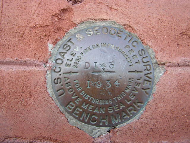

paden cash, post: 428549, member: 20 wrote: 1934 USGS disc
The 1934 disk at the Norman depot and a line of bench marks along the tracks were by the US Coast and Geodetic Survey (US C&GS), the predecessor name of the National Geodetic Survey, and NOT the US Geological Survey (USGS).
If it was reset or has a 1-ft blunder, there is no indication on the data sheet. Perhaps this needs to be rechecked and reported?
https://www.ngs.noaa.gov/cgi-bin/ds_mark.prl?PidBox=FJ0332
(not my photo)
Posted : May 16, 2017 9:22 pm
Bill93, post: 428667, member: 87 wrote: The 1934 disk at the Norman depot and a line of bench marks along the tracks were by the US Coast and Geodetic Survey (US C&GS), the predecessor name of the National Geodetic Survey, and NOT the US Geological Survey (USGS).
(not my photo)
You are correct Bill. This and the other recoverable D series BMs up and down the tracks were the BMs we attempted to reconcile with the FEMA RMs. Only one of the FEMA RMs was recovered at the time and THAT datum disagreed with these USC&G monuments by 1 foot. At that time the powers-that- be (my employer and the City engineering department) decided to maintain the FEMA datum and disregard these 1934 monuments since the FEMA hydrology of the area appeared to have been calculated from the datum that was in error by 1'. That was the mistake that was rectified just a few years ago and make the FEMA panels reflect elevations more closely tied to the USC&G datum (adjusted to NAVD88). I merely ran about 12 miles of levels just to be told it wasn't necessary. 🙁

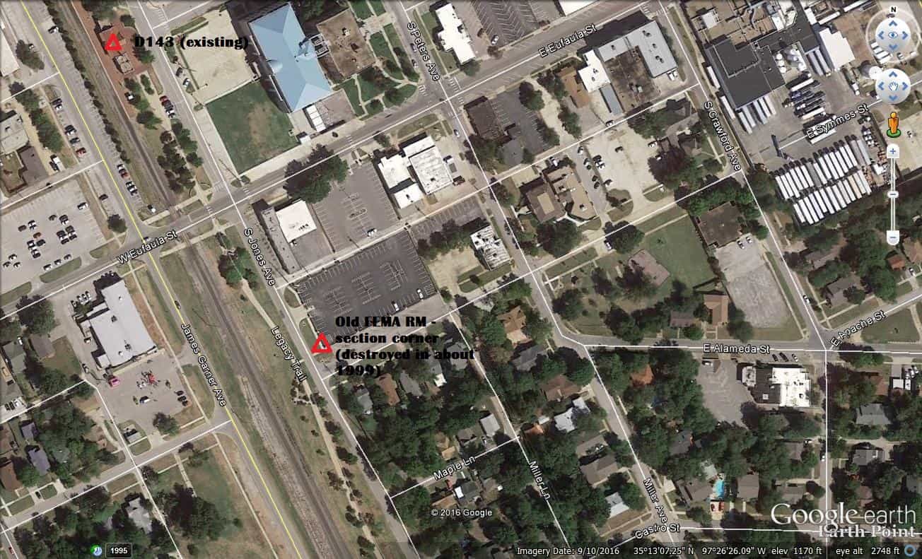

Sorry for the confusion. Here's a pic of the location of the "bad" BM listed by FEMA on an old panel that was actually the reset, not the disc in the wall of the depot, and its proximity to the closest 1934 BM. How they ever wound up 1' different is a story lost to the ages. I didn't think it was a good idea at the time to ignore the 1934 monuments, but my boss and the folks at the City did...it came back and bit everybody in the butt 25 years later.
Posted : May 16, 2017 9:55 pm
