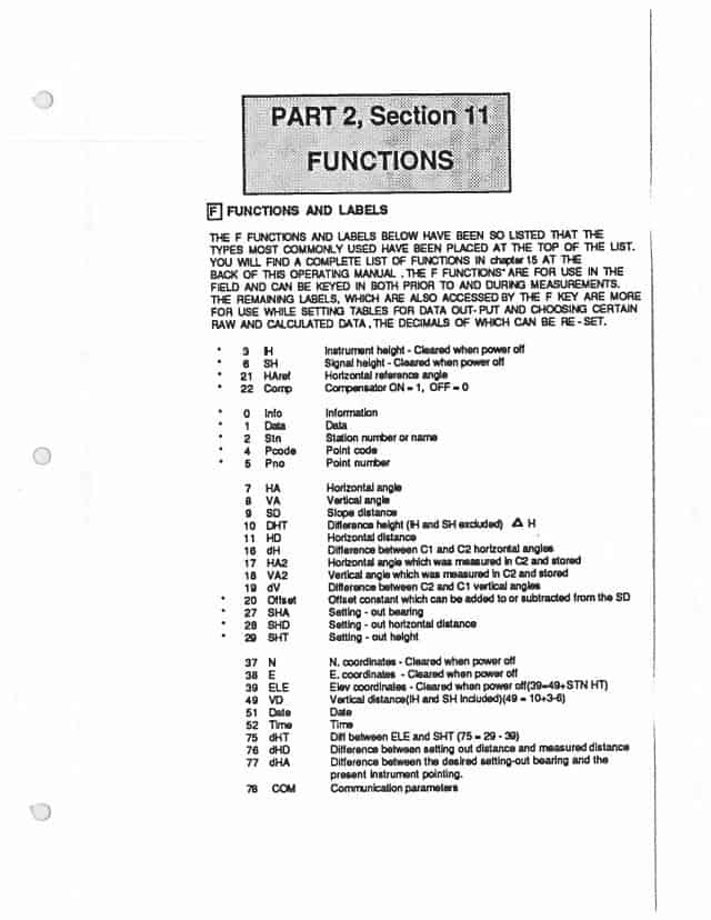

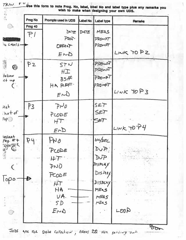

You have to write a USD program in order to store data to the on-board memory. I'd have to dig through the manual to understand these programs again....but one was probably for station set up...gather topo...stakeout.

If I remember correctly, it wasn't that difficult to enter a UDS program (once you get into the mindset that you actually have to dedicate some time to understand) and ever easier to use it once you understood what it was going to prompt you to enter.
Should only take 20 minutes to enter the UDS programs that I provided. Then initiate the first one, which will link to the next...In my mind - downloading may be the most challenging.
I have attached a couple pages that might help you make sense of what I provided earlier.
I remember using Roadline and Refline programs a bunch, but those were programs that you had to purchase. They must have handcuffed the software to keep you from creating those programs yourself.

1-19 are very much separate from the higher numbered programs. You do not go through program 20 to start into UDS's, they have to stand alone for collection. I, as well, don't remember what each number means by memory anymore, but, the first sets up the instrument and the second should set up the station, after that it collects the initial point and then is set to repeat collection. At least, that is what it looks like.
