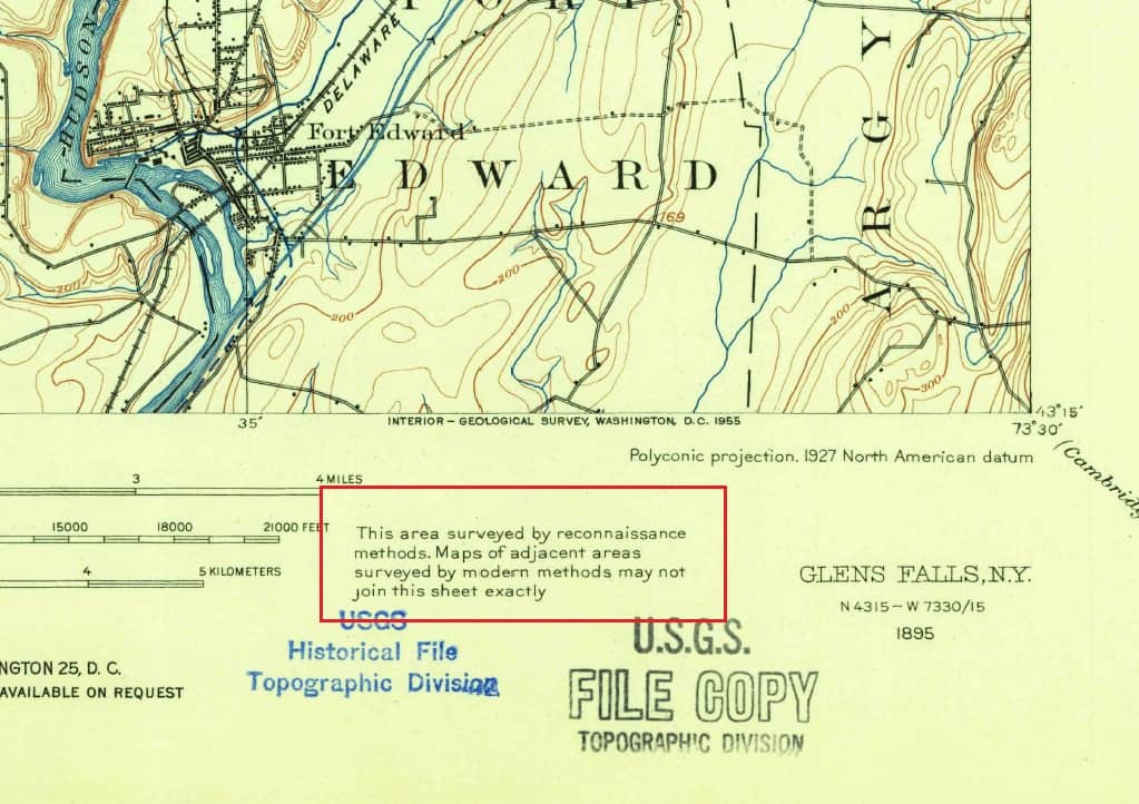

I am thinking this note probably refers to USGS using some visual surveying in some areas in order to get the map published and it was not necessarily survey accurate when the features on adjoining maps were more precise. Any other ideas as to the meaning of this note on the 1895 quad sheet?

Probably what we call remote sensing today. Indirect, stealth methods - like triangulation of major features from each end of a measured baseline, perhaps.
Given that some of the field guys may have been trained by Civil War vets, it would have been an acceptable and common method for expedient mapping.

Although dated originally 1895, that map is some time after the 1927 projection. I suspect the note refers to a reconnaissance inspection related to a revision date.
Yep, that's still here or nope, that's gone type of thing.

The image you show has 3 dates on it. Without knowing the date that note was put on the map it's hard to guess what the older, rougher methods were.

BajaOR, post: 342923, member: 9139 wrote: The image you show has 3 dates on it. Without knowing the date that note was put on the map it's hard to guess what the older, rougher methods were.
The same note is present on the 1895 quadrangle
