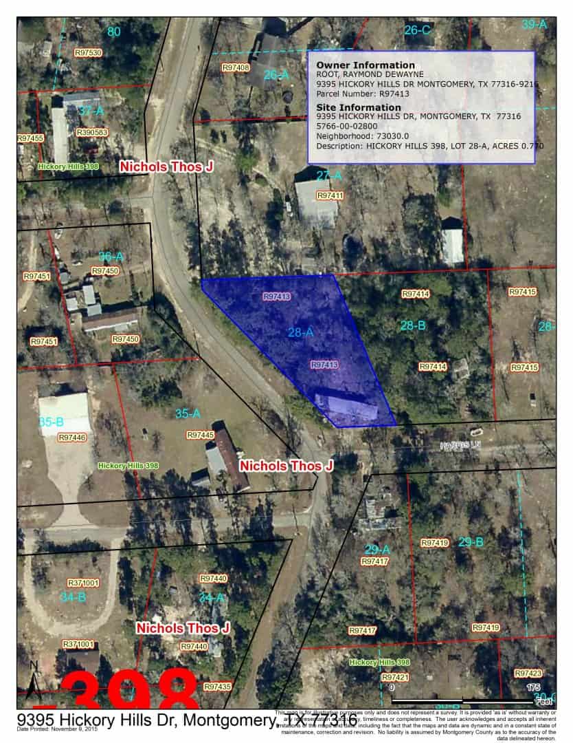

Does this help any? Where is Mr. Oblivious, when you need him? Tell us a bit about it. Is this it? What are some of the dimensions on said plat?
Thanks!
One of our posters sent me this.
Nate

Using that photo of the tax map, and the Google Earth ruler, calibrated on a football field ;-), and pulling from fence at 29-C? to the right of 29-B to the approximate R/W line on the map of 29-B, I measure right around 60'. However, just pulling fence to fence it's closer to 45. This would be a fun one to work on and hunt down, just not for the client Mr. Oblivious.
