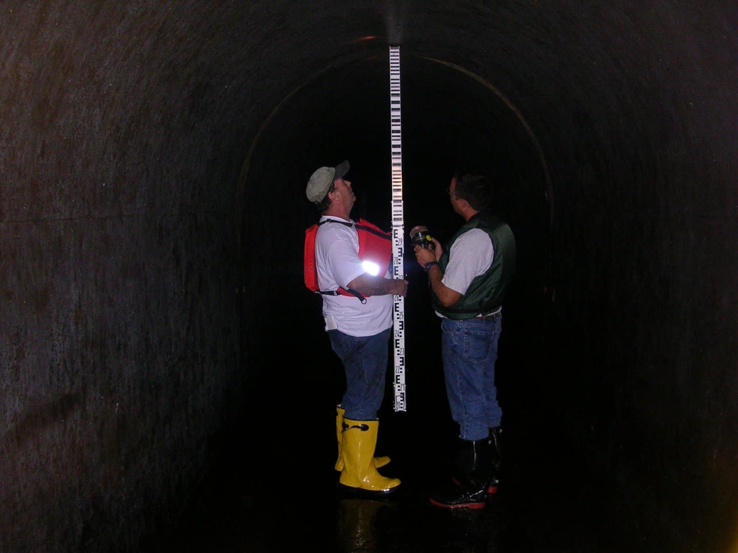

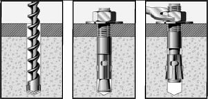

We usually use the standard anchor bolt grout (powder) when setting points in concrete. In October 2015 we had to set 17 bolts for settlement monitoring in the roof of a water tunnel. I bought a tube of grout so that we could use a caulking gun to inject it into the holes we drilled, figured that would be easier than trying to get grout into the holes from below. Today we went back to resurvey and a few were loose, although none fell out. The grout in the loose ones is like putty, not hard.
I don't remember what we used, but I was pretty sure it sounded like the right thing to use at the time. I do remember it was touted as "quick setting". I am looking for advice from anyone who has done something similar. My client researched this recently for a different project he was doing on a vertical wall, and the advice he found was to make sure the hole is free of any drilling dust. We try to blow the dust out with a small plastic tube, but he said it should be vacuumed out.

I haven't done overhead but maybe a mechanical anchor? My experience with these is you need to be careful with hole diameter (wobbling the drill) as they don't bite in an oversize hole and you get a mess of different lengths of protrusion.
There are some epoxy grouts out there that claim to be able to be placed underwater.
Posted : October 4, 2017 1:13 pm
Roof Bolts in Mines use a fast setting binary epoxy grout. I have used the mechanical bolts that Richard shows above, and they work good IF (as Richard points out), you have a straight, "clean" hole (w/o wiggles).
Posted : October 4, 2017 1:21 pm

I would guess that any minor earth motion may jiggle the bolts enough that gravity can ease them down a squinch before the grout fully sets. When setting a grout in a hole drilled down it is easy to get the air out. It is easier to trap air when filling from below. Any gasses released during curing can also work against the hold.
As I recall in the Boston Tunnel they were told what would work and decided standard grout was cheaper.
I would suggest you double the hole depth and anchor length when drilling up.

there is no force on these other than gravity, and they are small carriage bolts with a rounded head. We are going to reset the loose ones, using a wire brush to clean out the hole first. I wish I could remember exactly what we used, but it was nothing special, bought at a local hardware store.
I hate to go to the trouble of drilling a bigger hole and putting in an anchor first, but that may be the way to go next time.

I have always used epoxy and blind hole anchors of some sort. For the bolt use an eye bolt.

Jim...that is a 4 m rod folded in half so that we could get it on the points (inverted).
Today's tunnel was smaller (I believe it is 8 foot high by 3 foot wide rectangular), so we used a 1 m rod (inverted) on all of the bolts. It is hard to get the rod level using a level bubble because it is opposite from what you are used to.
As for an eye bolt, we needed to make these as unobtrusive as possible because we don't want anything to catch on them when they open up the flood gates. They said they had them totally open recently, but usually they are open 0.5 to 1 foot at most (twin barrels)
Posted : October 4, 2017 2:34 pm

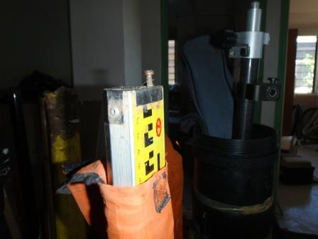

John Hamilton, post: 449522, member: 640 wrote: we want them rounded so that we can level to them easier
We have this on the base of one of ours, not sure why I put it on one side and not in the center:

I suggest using a http://www.homedepot.com/p/Quikrete-8-6-oz-Fast-Setting-Anchoring-Epoxy-862030/203604177&apos ;">2 part anchor bolt epoxy for all your monument setting needs. Get it on the concrete supplies aisle of your local big box.

The two part epoxy stuff will mix in the injection tube and it sets very quick.

I also use this http://www.homedepot.com/p/RectorSeal-EP-200-2-oz-Epoxy-Putty-Stick-97601/100124697&apos ;">epoxy putty. Easier to use for smaller jobs. It's on the plumbing aisle.

I would think that for your application the key is to hold the bolt in place long enough for the adhesive or epoxy to set. If the vertical dimension of the tunnel is 8 ft. a 2"x2" wooden pole 6-1/2 to 7 feet long and car jack should hold the bolt in place until it sets.

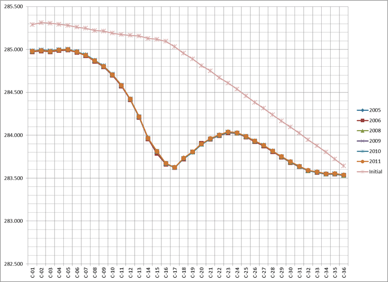

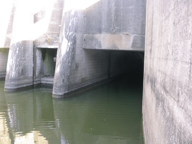

we monitor the outflow tunnels under earth dams. For some reason we only do the tunnels that were constructed as laid down sections of concrete. There are several dams in the district that have outflow tunnels drilled through rock, we don't monitor those. One of the tunnels (and the dam) has settled quite a bit. The top line is the iniital survey (before settlement). Elevations in meters. A bit of a ponding problem in the middle. The are of greatest subsidence is directly under the crest of the dam, it has sunk about 1.5 m (5 feet). But our leveling since 2005 doesn't show any more movement.
I watched a video presentation about the construction of this particular dam, when they were building it the whole site turned into a watery mess. They tried sinking electrodes into the ground and running electric current through it (??). In hindsight, probably not the best place to build a dam. Not sure exactly how much it weighs, but the dam is 800 feet wide at the base, 24 feet at the top, 9900 feet long, and 83 feet high. So it is heavy. For many years the settlement benchmark was a spike in a tree about 200 feet downstream from the toe of the dam. Then it was replaced by a disk in a concrete monument in about the same location. We started doing the surveys in 2005, at which time we started doing GPS for an external tie. However, it appears that the nearby benchmark is fairly stable, although one would think that the effects of such a heavy structure would extend out from the footprint of the dam. I believe the settlement is due to compression of the soil underneath the dam rather than a "bending" of the bedrock, that is why it doesn't manifest itself in movement of the nearby benchmark. I have no idea how far down it is to bedrock, but the movies I saw didn't show any there, just water and mud.
