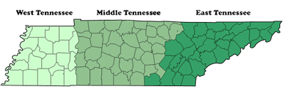

In the northeast corner of West Tennessee, the difference is about 0.14'.

"the northeast corner of West Tennessee"
I don't recall seeing West Tennessee specifically delineated on any maps commonly found at your corner gas station.:)

Mr. Cow, I believe you'll find the area Tommy is talking about if you look in the area of the intersection of the boundary between the State of Tennessee and the Commonwealth of Kentucky and the west side of the Tennessee River. Not precise, but close...
Posted : October 19, 2016 9:00 am
Ah. I see. So the northeastern part of West Tennessee would be near Paris, for example. My, my, my. East Tennessee is much larger than West Tennessee.
Posted : October 19, 2016 9:29 am
stephen-ward
(@stephen-ward)
Posts: 2244
Holy Cow, post: 395990, member: 50 wrote: Ah. I see. So the northeastern part of West Tennessee would be near Paris, for example. My, my, my. East Tennessee is much larger than West Tennessee.
That's because you forgot to account for Middle Tennessee. I couldn't tell you off the top of my head where the lines run but most non-geographically challenged folks that live here know that the state is divided into three grand divisions, (East, Middle, and West). You'll see it referenced this way on the evening news, and on all things governmental.
