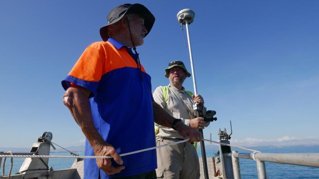

Sometimes it's an advantage to the have the standard rover + bluetooth DC setup. In the photo below we are marking the proposed installation position of offshore mooring components, in this case 5 tonne anchors. I'm standing next to the guy with the rope that has a 20kg weight on it, ready to drop when we pass over the mark as identified on the DC. Being detachable allows me to get someone else to hold the rover next to the rope man, while I can take the DC to the helm and use it to steer to the mark.

That's true. Using RAMS, you can see and control a receiver from anywhere in the world over the Internet. With a mobile router you can do it over intranet.

Just curious, why not mount the receiver to the railing? I have no experience with anything offshore.

How do you mark it?

We can do, and do so when doing soundings so that the receiver is over the transducer, but in this case the drop position may move so we would need to move the receiver, but the main reason is so that the receiver wont get caught by a rope or something else that could rip it off.

When we pass over the mark, drop the weight, it is still attached to the rope and a float is attached to that. Divers can then follow the rope to the seabed and hence the mark, and in this case the 5 tonne anchors will be suspended underwater with lift bags (depth is only 18m) and taken to the mark on the seabed.

I see! Round her we call that dallying up thumb. I've known a few cowboys in my life and some of em don't have a thumb. Makes perfect sense!
