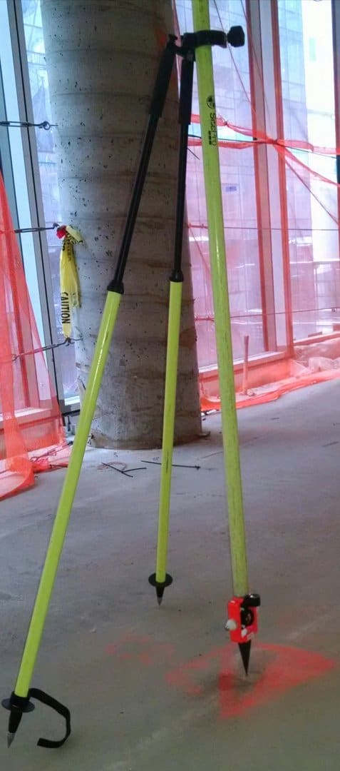

Looks like we are getting somewhere Dave! I still want to clarify a few things...
I can understand why you were asking how do you know if a prism is nodal...seco makes mini prisms that look exactly like the one you pictured that are not nodal. http://www.engineersupply.com/seco-mini-stakeout-prism-with-site-cones-6405-10.aspx
So I guess if you want the -30 mm offset you go with the one in the link above, understanding its not nodal.
Why did no one suggest using the larger 62 mm pole? If the point errors are reduced because it is nodal, is there still an issue? Is it just a matter of the weight? It seems like the 62m would be good for a backsights correct?
What are peoples setups like? Working for a construction company and having to climb forms, layout on top of walls, walk on rebar....I use a 30" rod that expands to 5' with a mini bipod. The seco mini prism pictured above would be great because I could put it on the bottom of the pole. Do you use a rod when you layout anchor bolts??

davidgstoll
(@davidgstoll)
Posts: 649
Doka1,
"...having to climb forms, layout on top of walls, walk on rebar...."
Yep. I like the idea of the 30" rod. That would make it easier to lay out anchor bolts on a mat footing. Before, I've always used a mini, but with an I-man at the gun. Now I'll have to adapt to this brave new robotic world. I never thought about having the active-track prism on top and the Nodal mini on the bottom. Genius! Best of both worlds, and you can keep the data collector in its cradle on the pole. The only problem would be putting a blindfold on the prism not being used, to switch between the MT1000 and the mini. Oh, and are there 5/8-11 threads on top of that Nodal mini?

doka1
(@doka1)
Posts: 5
lol, I wasn't thinking of two prisms, but it could work I guess. I am just saying that carrying the mini in your pouch kind of sucks because its too hard to read the screen and hold the mini. Btw, we have 3 robots in our company and the consensus among the three of us is that we don't want carrying around 4-5k around the jobsite (multitrack prism, radio for ts, computer for ts, pole...)
what about the 62mm prism dave???? what are your thoughts?
I feel comfortable with the 30" height and the bipod. When I check my rod in the office, I set up the 30" pole with the bipod and spin it, the bubble is very sensitive. I know this may sound trivial to some people but the 30" pole height seemed too high for me before. But then I think about how much we used to use a plumb bob with the prism on the line and feel a lot better with the 30" steady rod than the instrument man plumbing down 30". Using a plumb bob with a prism mount is truly an art....

davidgstoll
(@davidgstoll)
Posts: 649
Doka,
"Using a plumb bob with a prism mount is truly an art...."
Agreed.
"...carrying the mini in your pouch kind of sucks because its too hard to read the screen and hold the mini."
Yep.
"What about the 62mm prism?"
Makes a nice backsight, and it's cheaper than the mini. But for use with a robot, I don't know that the extra diameter adds any benefit. If using the 62mm made the robot less likely to chase vests, then it would be a hands-down choice. Does it?
