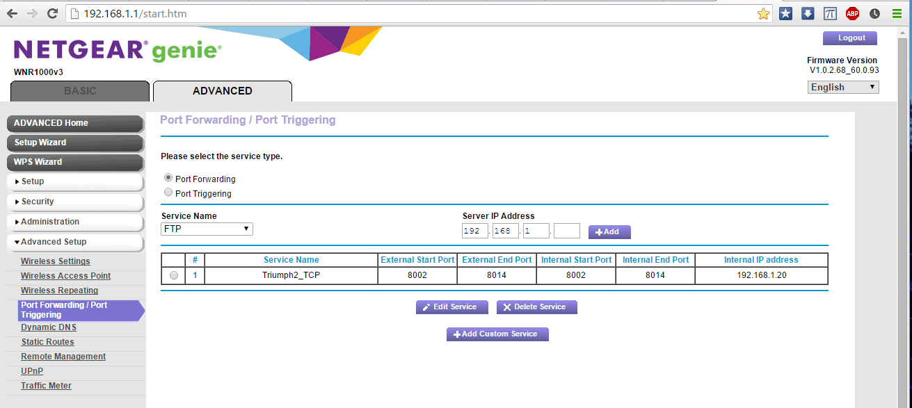

shawn-billings
(@shawn-billings)
Posts: 2691
If your data collector was connected to the same router, then you need to use the local area network address (such as 192.168.0.1) instead of the internet address.
With a device connected to the internet on the same router as your base, type "what's my IP". The return will be your IP address. When the DC is connected to the internet using a different internet connection from your base, you need to use this IP address.
Posted : January 18, 2016 1:48 pm

matt8200
(@matt8200)
Posts: 145
Member Vendor
You will need to forward the ports you are using through your router to the local IP address of the device hosting the corrections. Your router setup can typically be accessed at http://192.168.1.1/ . Here is an example of my router where I forward ports 8002 through 8014 to IP address 192.168.1.20, which is the local IP address of a Javad Triumph-2 connected to the router through WiFi and transmitting corrections through TCP:
Once this is done you will be able to connect to the connection stream using your public IP address. Use http://whatismyipaddress.com/ to determine your public IP address.
Posted : January 18, 2016 2:32 pm
