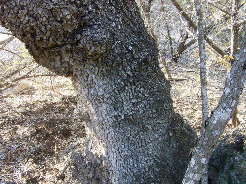

BTW, since photos are always fun to see, here's a photo of one of the Live Oak bearing trees from which I replaced a corner that had been originally located in 1854 (I cheated and checked. It was 1854, not 1853.) The mark is so clear that you can even see it quite plainly in the photo.

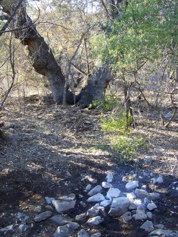

This is what the scatter of stones looked like that was evidently what remained of the original stone mound from 1854. The whitening is limestone dust from drilling a hole at what I judged to probably be the center of the mound based upon examination of the scatter, a location that the bearing trees 7 varas distant showed to be 1.23 ft. distant from where the corner had actually been located in 1854.

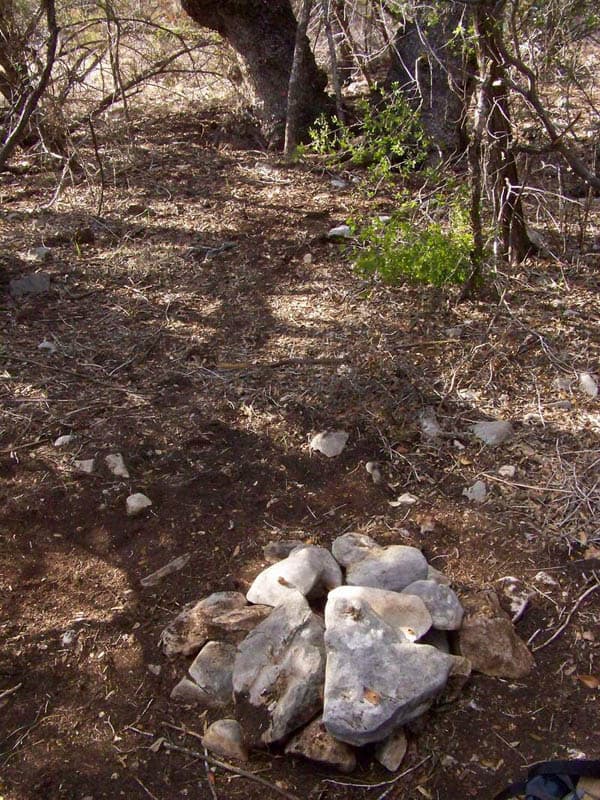

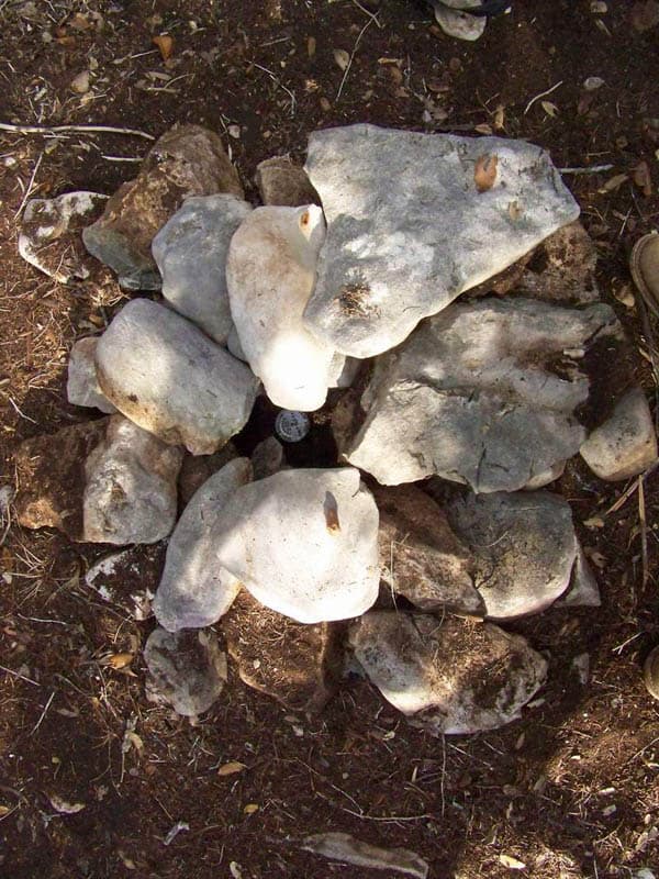

I set a rod and cap to mark the corner and rebuilt the mound around it using the stones in the scatter. A couple of years later, when I took a group of folks from a local historical society to visit the corner and see the bearing trees, the rock mound looked surprisingly good.
