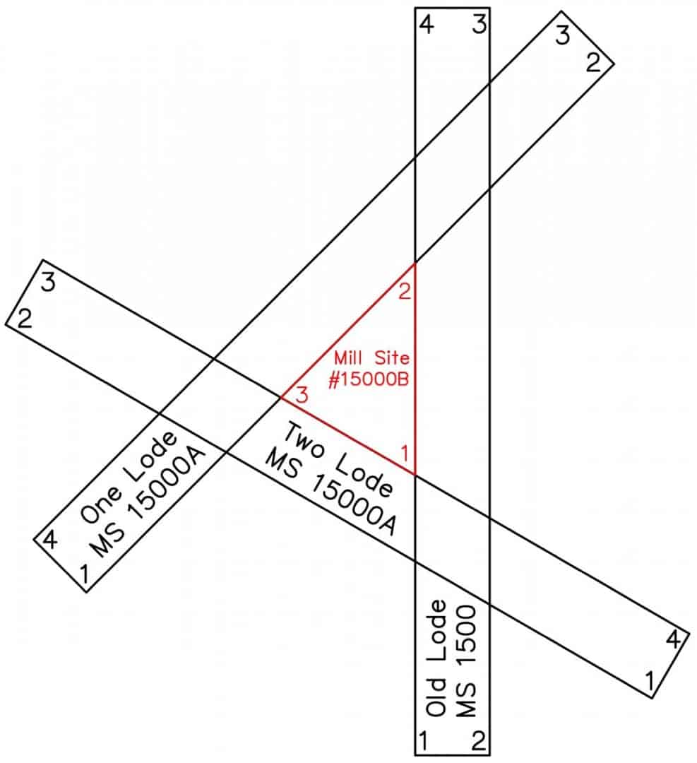

Here is an interesting twist on a gap not of record. While the parcels are three lode mining claims and a mill site, please consider that the solution is not dependent upon a specialized knowledge of mining claims.
In 1882, the Old Lode (MS 1500) was surveyed by U.S. Dep. Mineral Surveyor, Albert E. Chase with a solar transit and 500 ft. steel tape. The plat shows it to be 1500 feet long and 150 feet wide. The plat and field notes show a connection between Cor. No. 1 and a section corner on the south township line to be S14?ø27'W, a distance of 8010.8 ft. All four corners are chiseled stones surrounded with a mound of stone. The patent was issued in 1885 and it does not state any conflicts or exclusions with other claims (acreage of 5.165 acres).
In 1902, the One and Two lode claims and a mill site (MS 15000 A&B) were surveyed by U.S. Dep. Mineral Surveyor, A.J. Ventress with a Gurley Light Mountain transit and 500 ft. steel tape. The true meridian was determined by direct solar observations. The plat shows both lode claims to be 1500 feet by 150 feet and the mill site boundary is coincident with the side lines of the Old, One, and Two lodes. The plat and field notes show connections between Cors. Nos. 1 of the One and Two lodes and Cor. No. 1 of the mill site and a section corner on the south township line (same PLSS corner as MS 1500) to be S9?ø24'W, 8194.3 ft, S17?ø27'W, 8251.6 ft., and S13?ø31'W, 8556.5 ft., respectively.
All 8 lode claim corners and Cors. No. 2 and 3 of the mill site are chiseled stones surrounded by mounds of stone. Cor. No. 1 of the mill site falls on a 8 x 3 ft. boulder, standing 2 ft. above the ground and marked with a chiseled "+". The patent was issued in 1904 and it expressly excepts and excludes from the patent that portion of the Old Lode (MS1500) in conflict with the One and Two lodes (acreage of 9.661). The patent states that the mill site has an acreage of 1.316 acres.
Plat for Sur. No. 15000 A&B showing conflict with Old Lode, Sur. No. 1500.

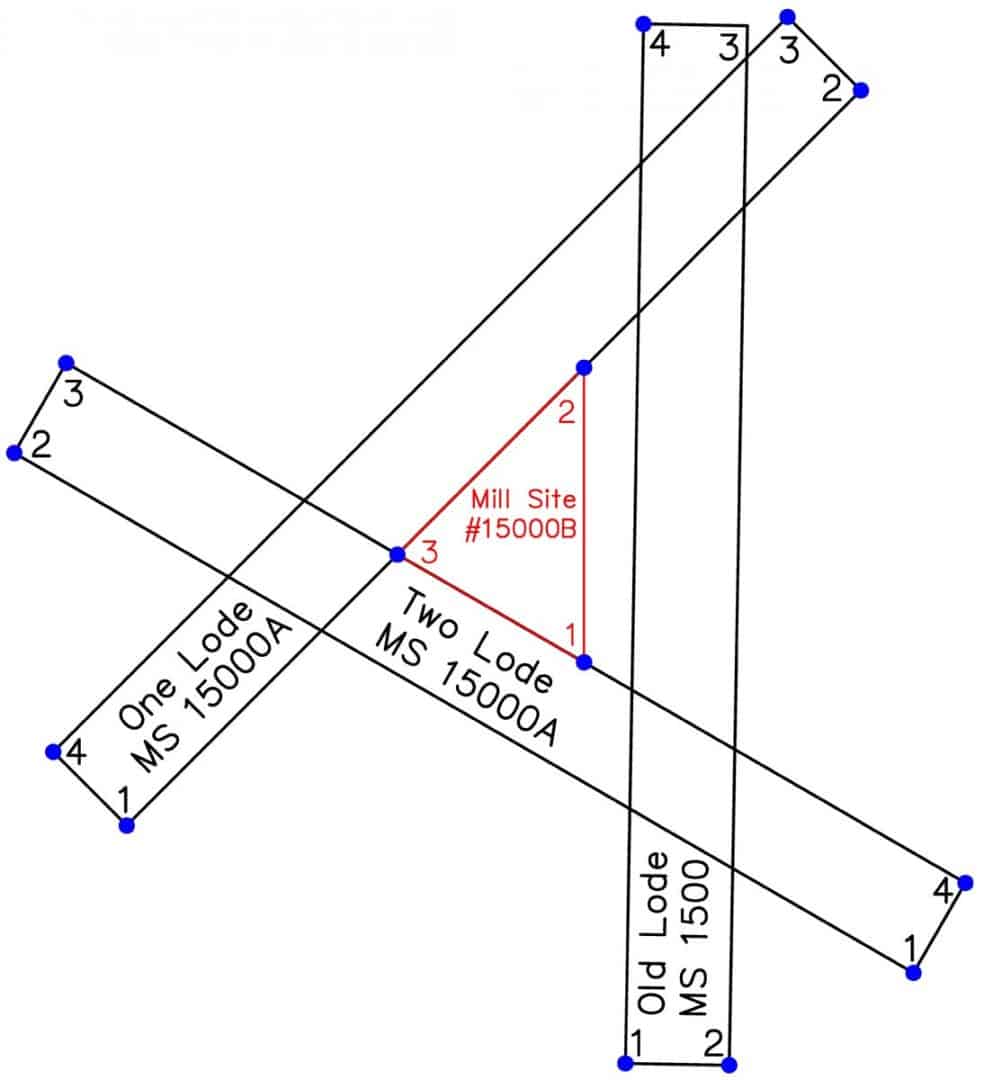

I conducted a field survey and found all of the original corners either firmly set or reestablished from the stone mound or original accessories). The exception is Cor. No. 3 of the Old Lode, which currently falls in a road. The measured courses and distances "reasonably" match the record dimensions for Sur. No. 15000 A&B. The distances of the Old Lode reasonably match the record. Line 1-2 of the mill site matches record of N0?øE, but Line 4-1 of the Old Lode is S1?øW. The mining improvements for the Old Lode fit the found position, not the position shown on Sur. No. 15000 A&B. The area is covered in pine forest and there are no improvements placed on any of the boundary lines (i.e. no fences). My client owns the mill site and wants to build a cabin. There is an existing road that provides access from the north to the Old Lode.
Cors. Nos. 3 and 2 of the mill site create two angle points in Line 1-2 of the One Lode with fallings of 0.4 ft. and 0.6 ft. respectively. Cors. Nos. 3 and 1 of the mill site create two angle points in Line 3-4 of the Two Lode with fallings of 0.3 ft. for both corners. Instead of being coincident, Line 4-1 of the Old Lode is approx. 74 ft. east of Line 1-2 of the mill site.
The field notes for the mill site (MS 15000B) clearly state that Cor. No. 1 is a chiseled "+" in a boulder and was set at the intersection of Line 4-1 of the Old Lode and Line 3-4 of the Two Lode. The field notes continue, "Thence north along Line 4-1 of the Old Lode a distance of 425.2 ft. to Cor. No. 2 at the intersection with Line 1-2 of the One Lode." There is a gap of 0.82 acres.
Preliminary plat showing the found positions of the 3 lode claims and mill site.
These claims are private inholdings within a national forest located somewhere in Colorado. What would you do with the "technical gap" (i.e. it is not of record).
  1. The monuments are still in their originally established positions. Hold everything and show the gap. The gap is Federal interest land.
  2. Hold the call to the senior line over the original monuments. They are closing corners. Set new monuments at the true intersections.
  3. Despite the suspected blunder of Dep. Ventress there is no gross error or fraud and since the other criteria of "mistake" is not defined in Chapter X of the 2009 manual, it is appropriate to bend Line 4-1 of the Old Lode through Cors. Nos. 2 and 1 of the mill site. This is in keeping the general rule that no gap in the record, no gap on the ground. (Sorry, this one is specific to mineral surveys.)
  4. Call your buddies at the USFS and BLM.
  5. Other solutions?

Cor 1 and 4 of the Old Mill Lode are existent. The surveyor of the Mill Site was supposed to find them and use for establishing corners 1 and 2 of the Mill Site. The Mill Site Plat shows the east line of the Mill Site coincident with the west line of Old Lode, this shows the intention to leave no gap. If there were two versions of the west line of Old Lode then there would be a question of fact which one was referred to on the Plat but that is not in this case. The monuments establish the line.
Granted the BLM may be of the opinion that the Mill Site corners establish the boundaries of the patent although they wouldn't in the case of an overlap.
Posted : July 17, 2017 10:15 pm

Dave Karoly, post: 437366, member: 94 wrote: Cor 1 and 4 of the Old Mill Lode are existent. The surveyor of the Mill Site was supposed to find them and use for establishing corners 1 and 2 of the Mill Site. The Mill Site Plat shows the east line of the Mill Site coincident with the west line of Old Lode, this shows the intention to leave no gap. If there were two versions of the west line of Old Lode then there would be a question of fact which one was referred to on the Plat but that is not in this case. The monuments establish the line.
One would hope that Mr. Ventress would have done that, although the positions of Cors. Nos. 1 and 2 of the mill site do not seem to bear that out from an analysis of the two surveys.
