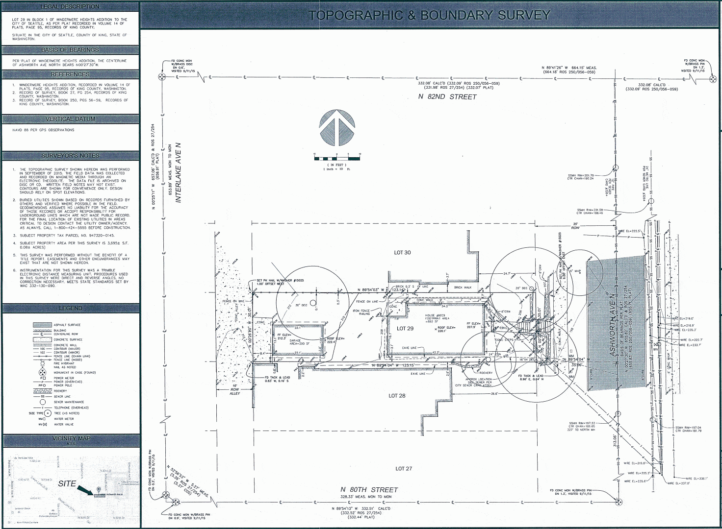

New information: I was able to scan my paper copy of the latest survey, which was done on 9/14/2015 and have attached it to this post. Because it was part of the plan set submitted to the city for permitting and made available to my neighbor when she requested it, I believe it is part of the public record. However, I have removed the name of the surveying company.
This survey also contains references to the three other recorded surveys:
1. 1907 survey (from Book 14/Page 95 of Plats)
2. 1981 survey (from Book 27/Page 254 of Plats)
3. 2007 survey (from Book 250, Pages 056-059 of Plats)

If that is the survey of the lot in question, the survey shows no corners measuring 30' or even close to it. I am wondering where the .01 is coming from. I see 3 found corners and no found or set 4th. The 3 that were found were either offsets or found almost 1' off. This is typical of a crowded neighborhood with horrible fences but to narrow it down to .01, I don't see it.

So the 30.01 seems to be from prorating the longer measured distance against the shorter original platted distance.

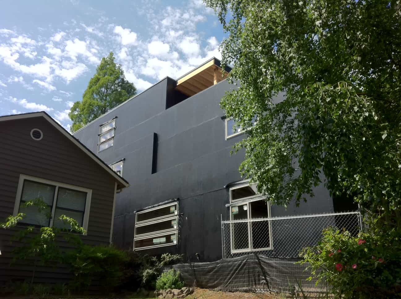

I live next door to what we call the Starbucks house. Flat roofed box with cement board siding fastened with stainless steel screws and painted Navy grey. However it is more than three feet from the boundary, has increased the value of my slice of the pie and I genuinely like the neighbors. Sam brews a pretty good ale and Lisa's paella is the best.
In the survey that the poster provided you note that the subject house was about three feet from the lot line before it was replaced, and it appears that the south neighbor's house (photo supplied) is only two feet which is why these two structures look to be too close together. They are. I hope the new house has cement board siding because when either of them catches fire or needs to be painted it is going to be a problem. Note how the upper area of the new house is stepped back a little bit as it goes up. This probably brings the upper levels into compliance with a portion of the setback code. Note that I said probably. I bet that the house to the south had been added onto and when doing so it also took advantage of the side yard being less than prescribed, if it was permitted at all. The house to the north appears to also be less than the prescribed five feet but the difference is probably not so photo dramatic.
New construction in residential zones have to only be set back from the street by an amount equal to the average of the neighboring structures when they are less than standard. I suppose that there may be provisions for adjusting this in order to preserve a tree under the guise of not restricting ones right to develop their lot to the fullest. Expect that the tree will die or be removed on a Sunday or holiday sometime soon.

Jered McGrath PLS, post: 372523, member: 794 wrote: So the 30.01 seems to be from prorating the longer measured distance against the shorter original platted distance.
But there is only a difference of 0.01' between the original platted distance (655.83') and the last surveyed measured distance (655.82')--not enough for a proration to allocate 0.01' to every lot on the block. Also, the original platted distance is slightly longer than the surveyed distance, not shorter. That is, of course, if we accept 655.83' as the original platted distance. This is the number you get if you add up all the measurements on the plat between the SE and NE corners.
