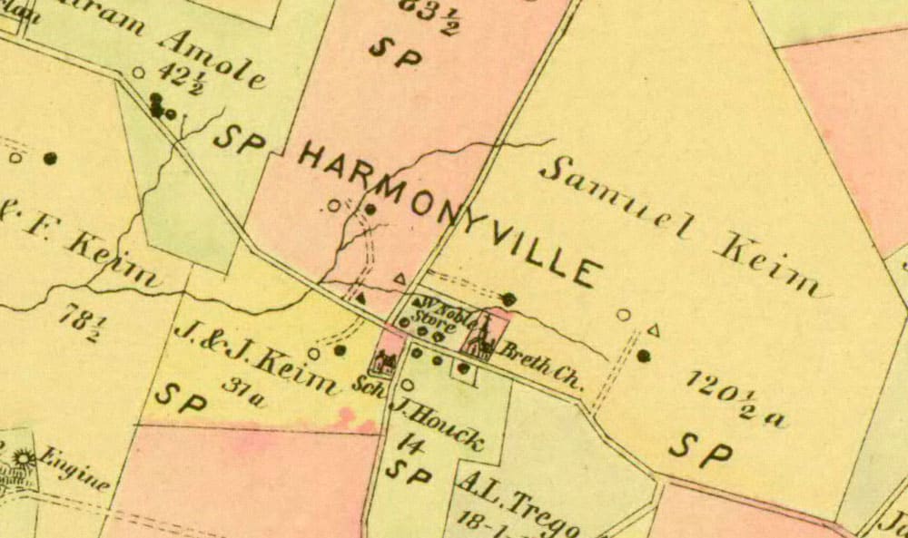

Here is one more map that the Google turned up, this one at the link below. It's a detail of a map of Warwick Township in Chester County, PA from the 1883 edition of "Breou's Official Series of Farm Maps" published by W.H. Kirk & Co..
Note that the Schoolhouse labeled "Sch" is shown on place on this 1883 map and that the road that in the 1873 edition ran on the diagonal across the School tract is shown in 1883 as running along the East side of the approximately rectangular parcel the two triangles comprised, and making a dogleg at Harmonyville Road. What I get out of that is that following or contemporaneously with the purchase of the Western Triangle "B", what is now S Hill Camp Road was probably relocated to abandon the diagonal route that appears on the 1873 mapping,
Note that the names of landowners Nobles and Keim agree with the calls for adjoining owners in the description of Triangle "B"
The curving connection that exists between S Hill Camp Road and Hill Camp Road North of Harmonyville Road likely came about after 1883.

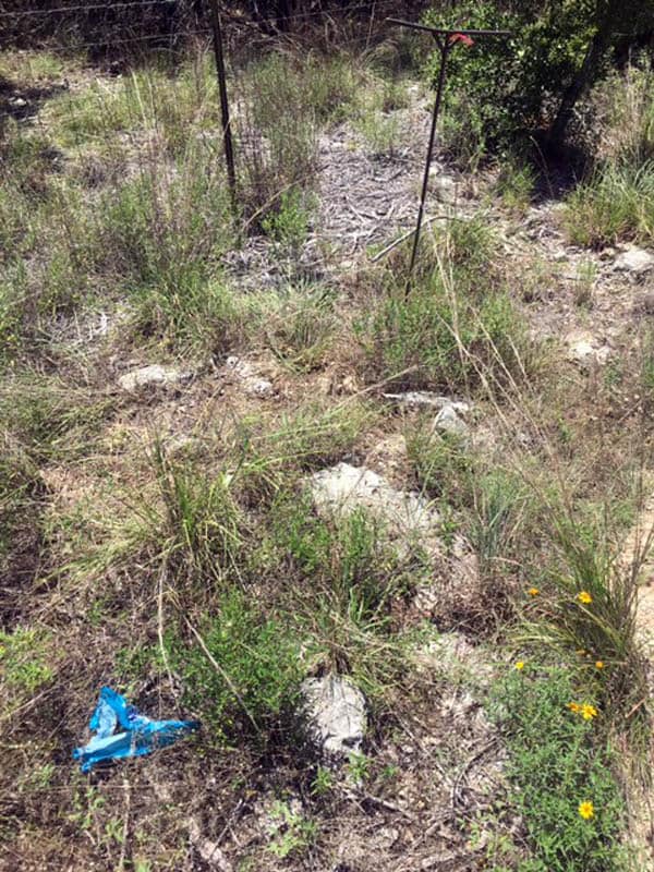

As a point of interest, do you own a sturdy probe with a tee-handle similar to the one that appears in the background of the photo below? It's probably among the most useful tools in my truck.

Kent McMillan, post: 445063, member: 3 wrote: As a point of interest, do you own a sturdy probe with a tee-handle similar to the one that appears in the background of the photo below? It's probably among the most useful tools in my truck.
An Estwing, no doubt.
Posted : September 4, 2017 9:07 pm
paden cash, post: 445071, member: 20 wrote: An Estwing, no doubt.
That probe was donated to me by a plumbing company that had unintentionally left it on my premises. I kept it safe for them for awhile and then the storage fees added up so much that I sold it to myself. It's a much better probe than I've found for sale at the hardware store, and simple to make out of 1/2 in. smooth steel rod if you have a welder. If I lose that one, I'll have a welding shop make me another. The key dimension is the length of the same since a gentleman would want the handle about belt buckle height for ordinary use and you might also.

Kent McMillan, post: 445072, member: 3 wrote: That probe was donated to me by a plumbing company that had unintentionally left it on my premises. I kept it safe for them for awhile and then the storage fees added up so much that I sold it to myself. It's a much better probe than I've found for sale at the hardware store, and simple to make out of 1/2 in. smooth steel rod if you have a welder. If I lose that one, I'll have a welding shop make me another. The key dimension is the length of the same since a gentleman would want the handle about belt buckle height for ordinary use and you might also.
I prefer mine a wee bit shorter to allow the legs and knees to work a little more efficiently. Working with a taller probe will eventually kill your sciatic. But I can understand using a taller one, most ladies do prefer such because of their taller pelvic bone.
But now you've confused me. Do you drill a pilot hole to use your probe? You posted a few days ago (and I quote):
"I'm going to guess that you mostly work in loose soils or talus if you can drive a #6 rebar 24 inches or longer with a 3-lb. sledge. I don't see a rock drill among the field equipment, which would be needed in most of the Hill Country of Central Texas. Must be nice to have it so easy."
I'm logically assuming you either drill pilot holes to probe or only use your probe outside of the Hill Country of Central Texas...where one cannot penetrate the surface to a depth of 24" without a rock drill.
Just out of curiosity, where was your picture taken?

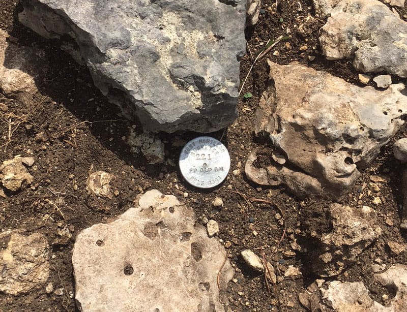

paden cash, post: 445077, member: 20 wrote: Do you drill a pilot hole to use your probe?
i have a hammer drill with a 5/8" x 20" bit that is perfect for punching small holes through pavement to be able to probe the subgrade. You can drill one hole and then drill holes splayed out from it. That is when the drill is used. Otherwise, in a soil that can be probed, there isn't any need for a pilot hole.
I took that photo within a few feet of where I snapped this one later:
(I use the probe also for probing in shallow soils. It's an easy way to do a quick search from a standing position, which is also best when searching for post and stump holes.)

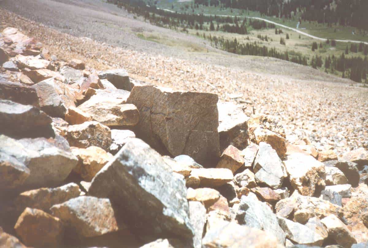

Please, Kent. While you are looking for piles of rocks that "look old" but may not be, HC and Dave are looking among a field of rocks for that singular stone set by a GLO surveyor. If like yourself, a surveyor has no experience looking for those "odd stones" that stand out from a field, hillside or mountainside of rocks, the experience is often fruitless. Both HC and Dave have that practiced eye to find a stone and you have a practiced eye to find splattered rock cairns.
The below stone is in a large scree slope. In 1932, a mineral surveyor ran a line within 100 feet to the left of the stone and ran another line within 85 feet to the right of the stone. I'm sure he searched for the stone. The "Other Corner Descriptions" section of his field notes stated that it had been destroyed in the slide rock, a plight not uncommon in that scree slope. Some will think that I was lucky to have found it, but luck often rewards the surveyor that makes a diligent search.
Cor. No. 4 of the Magnet Lode, Sur. No. 6437, set by U.S. Deputy Mineral Surveyor W.H. Powless on August 12, 1890.
The chiseling is vertical, with the "4" for the corner number to the right and "643" of the Sur. No. 6437 in the center of the vertical face.
