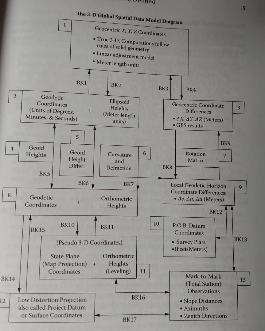

HICALS: I use both geolab (for 30 years) and starnet (more recently). In either software, you can use slope distances (which is what a mark-to-mark distance is) along with HI and HT. By setting HI and HT to zero (which is what happens if you leave it out), the distance is a mark-to-mark.

A more recent book, which I highly recommend, has a lot of information about transforming between various coordinate systems and data types.
4) The 3-D Global Spatial Data Model-Foundation of the Spatial Data Infrastructure by Earl F Burkholder; ISBN=978-1-4200-6301-1
Hopefully Earl (who sometimes posts here) won't mind if I post a diagram from his book. The book is very usful in that it explains all of this very well, and gives formulas for all of the transformations.
Posted : October 21, 2016 5:07 am
Looks like Earl Burholder's book may be just what I need to expand my knowedge on the subject. Thanks for the suggestion.
