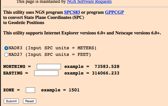

Some time ago, I converted my practice survey to SPC. As there were no known local SPC points to use for horizontal control, I picked a point visibly close to my starting point on Google Earth, noted the Latitude and Longitude, and converted it to SPC.
The point I picked was 43-40-30.54 N x -72-34-56.98 W, and the coordinates I came up with were 428317.201 northing x 1618591.509 easting.
I wanted to check back in with some of my distant (couple thousand feet away) points traversed to, and while doing so, put the above coordinates back into this "calculator":
and got absolutely whacko numbers:
I'm seeing that by definition NAD 83 SPC units are in meters; I thought I've been dealing in US Survey feet all along, but would that error account for whatever is wrong?
How'd my survey get moved to the fishing banks off Nova Scotia?:-S:-S:-S

I haven't tried to repeat the calculations, but it looks at first glance like you put in feet when the button was selected for meters input.

Bill93, post: 331901, member: 87 wrote: I haven't tried to repeat the calculations, but it looks at first glance like you put in feet when the button was selected for meters input.
You have no choice in the matter. NAD83 is meters, NAD27 is feet.

When you get coordinates on other side ofcworld, nost likely caused when you enter the Longitudinal wrong. It must have a minus sign, for West. Otherwise it assumes East Longitudinal.
Try meterss. Also check the Zone ID for Vermont.

If the program wants meters, then convert your feet numbers to meters before entering.
I don't know if you have survey feet or international feet, which will make a few feet difference in the coordinate values (what did you use to get the original coordinates?), but if you divide the given coordinates by the conversion factor to meters before entering, you will get reasonable lat lon values. Using survey feet should get around 43 40 30.54200 72 34 56.97999 which is a hundred yards SE of your driveway and 25 yards SW of the middle of the highway.

The general convention, as I understand it, is that State Plane Coordinates for NAD'83 is expressed in Meters, and for NAD'27 is feet.

U.S. survey feet x 1200/3937 = meters.
This is not the same as 2.54 cm = 1 inch !!!
It makes a significant difference when converting SPC coordinates.

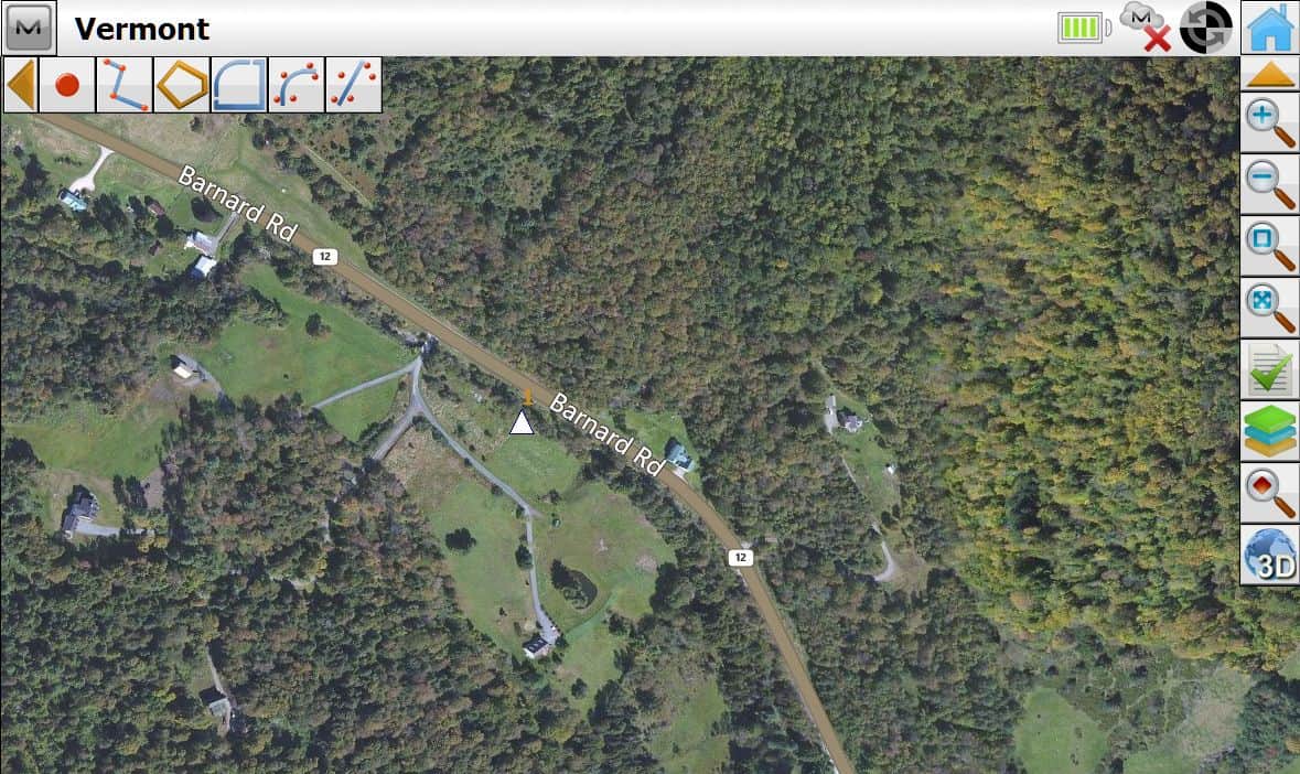

This is what I come up with from your data.
Geographic Coordinates
N43å¡40'30.54"
W72å¡'34'56.98"
Cartesian Coordinates
Northing 130551.282m
Easting 493347.678m
Northing 428317.00UsFt
Easting 1618591.51UsFt
Posted : August 15, 2015 4:37 pm

Lee:
That's the place. Is it as simple as taking the Coordinates in metric, converting them to feet, and using those numbers in the survey, thereafter keeping everything in feet? I'm seeing the error of my ways. I entered the coordinates in metric, expecting my software (TPC) to do everything.
I may well have to try this all in Magnet.:-)
