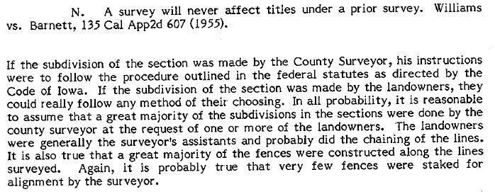

Just as an interesting side light I am attended the surveyors conference today and the speaker stated he disagrees with Lucas on surveyors noting fence as boundary when the deed line are out away from it. He said he tells his client to go see a lawyer when that happens. He's speaking on easements but this came up. At the same time he states that surveyors know more about property law than lawyers or judges. Go figure. He says Jeff is softening his view on this. Wishful thinking.
So someone asked him where the center of section is. He stated its only at interesecting line as a last resort. He would look for other evidence of corner establishment. He said he would take an old fence corner rather than intersectiong lines. Kind of confusing if you ask me.
From the same citation as above
Fence History
doubt and uncertainty
Agreement

My current project is among 25 well defined original block of 100 acre squares.
The division of those blocks are far from what many of descriptions would place the monuments.
Bearings along the fences vary 2°± from deed to deed.
The old fences do surround the proper amount of acreage.
Who am I to make create problem.
