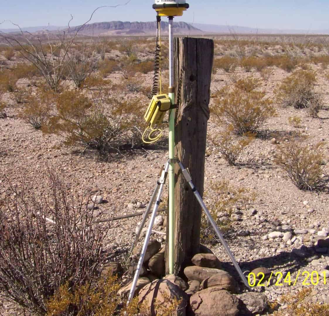

Here is a fairly typical fence post. The wire has been salvaged and reused on some other fence. Fortunately, the post itself was not the boundary monument. An actual surveyor had left a monument that marked the corner, thus saving me from having to spend valuable screwing around with trying to determine exactly which point in cartesian space associated with some feature of the post was that intended when the boundary in question was created. I realize that if this were just a GIS-grade mapping effort, none of that would matter, but this was a boundary dispute.

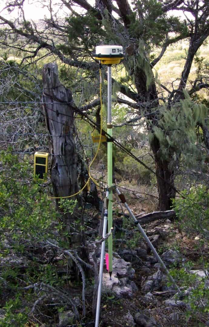

Here's another typical fence post. This one was used as a boundary monument by a surveyor who should have known better since it almost certainly looked pretty much like this when it got turned into a boundary marker after spending decades as a fence post. So, instead of him spending the time to do it, that was me figuring out where the line was and setting an actual permanent marker (the spike and washer set in a drill hole in a rock outcrop as seen in the photo) to relieve the fence post of the burden of being something for which it had no aptitude.
Posted : April 4, 2016 10:44 pm
OMG!!!!!! PINCUSHION!!!!!!!!!!!!!!!!
