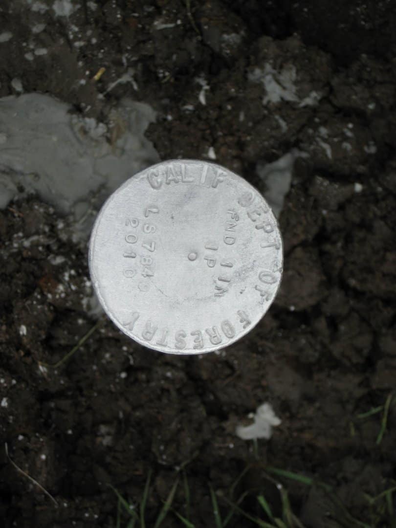

I rehabilitate or upgrade monuments on a regular basis.
Report what I find and what leave behind.
My most common method is to use the original material as much as possible, like insert rod in a drilled out chunk of rock, brick or concrete that I have buried in the ground.
Monuments of wood are usually replaced with a new shiny rod and cap.

thebionicman, post: 382635, member: 8136 wrote: If you don't replace them now (where they are), somebody will come in later and put them where they think they should be.
Memorialize the locations and file the map (please)....
And, better yet, if you're setting aluminum-capped monuments to replace the tacked hubs, stamp the caps "FD ORIG HUB" to add one more layer of information to what is on the ground.
Posted : July 26, 2016 9:24 am
Kent McMillan, post: 382640, member: 3 wrote: And, better yet, if you're setting aluminum-capped monuments to replace the tacked hubs, stamp the caps "FD ORIG HUB" to add one more layer of information to what is on the ground.
In the non-recording States i would consider that. Around here it would be noted on the map.
Posted : July 26, 2016 9:44 am
Posted : July 26, 2016 9:45 am
thebionicman, post: 382641, member: 8136 wrote: In the non-recording States i would consider that. Around here it would be noted on the map.
I take it for granted that the extent of research surveyors perform does sometimes dip into the end of the thoroughness spectrum that might not disclose the resurvey map. If in fact that is an unwarranted concern, then, yes, the note on the map should be sufficient.
