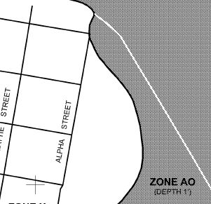

I have a client who tells me that the county is requesting an Elevation Certificate for a parcel that's in Zone AO with a 1' depth shown on the FIRM. I've not dealt with Zone AO before. The site is pretty flat; would it be appropriate to add 1 foot to the highest site grade and call that BFE?

I am not overly familiar with AO, however on the Fema Flood Certificate Form, where it asks for BFE in ( ) its states in Zone AO use base flood depth. In your case with the diagram you provided, 1' would be entered in that section of the form. Not to sure how to correlate this with elevations you will potentially obtain in the field, I would be interested if anyone else would know how to determine.

Just place the flood depth in the BFE, let the adjusters sort it out. For the purposes of complying with FEMA requirements/local floodplain ordinances the HAG plus the flood depth is the BFE for determining if the lowest floor is in compliance.

Zone AO is the magic zone where the water slopes with the ground. Had one where Lot 51 could build their house lower than the adjoining lotƒ??s ground which had to build way up in the air.

Interesting tale about the project that was the subject of my original post:?ÿ I prepared the EC, set a site BM, and delivered to my client.?ÿ ?ÿ When he called me out to do the as-built EC, I found that the FF was a foot or so below BFE.?ÿ Unbeknownst to me, he had built the house himself, ignoring the BM -- he just scraped a pad and built the house slab-on-grade.?ÿ Thus began a 6-month saga wherein he had to hire a hydraulic engineer to do a drainage analysis, which required me to run 8 each cross-sections, some as long as 2000'.?ÿ Fortunately for him, the analysis showed that he had enough freeboard to satisfy the county, which finally issued an occupancy certificate.?ÿ But it cost him a bunch of extra money to get there.
