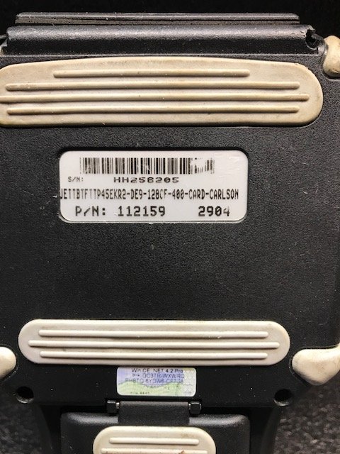

I have a fairly early Jett DC I bought from someone here (can't remember who) for a great price (less than $100). It's worked great until last fall when it started developing "stuck key" syndrome...characters would be repeated, without touching the touch screen, at times it would click away like a machine gun for a few seconds. I think it's starting to get worse, and I can't put rhyme or reason to what might be causing it. It's never been rained on; never dropped.
Before I start the hunt for a slightly newer unit (possibly with a slightly newer version of SurvCE on it), I thought I'd ask: Can the touch screens be replaced on these? I thought Nate did it but can't find that thread. Thanks in advance for any ideas.

Replacing it is probably pretty doable if you're okay with the idea that you *might* kill it in the process, but finding a replacement screen at a reasonable cost might not be so easy. I'd probably open it and see if I could ID the manufacturer and model number, and then see if they're available on eBay. If you buy one from a dealer you're likely to pay more than 10 times the direct-from-China cost.

Jim Frame, post: 425262, member: 10 wrote: I'd probably open it and see if I could ID the manufacturer and model number, and then see if they're available on eBay. If you buy one from a dealer you're likely to pay more than 10 times the direct-from-China cost.
Thank you Jim. I'll open it and see if there's a part number and see if it's socketed or connectorized. I know someone with a full on desoldering station in case it's not.

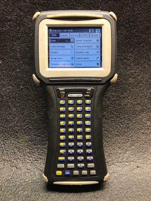

I have performed this surgery before with great success.
I picked up another Jett collector on eBay for $50 and took it apart before I dove into the Explorer.
You'll need some clear silicone to seal it back up, and you'll need a heat gun (used carefully) to help pry it apart.
I ran into one "hitch" is that the replacement screen from the slightly different model had a slightly different mounting than the Carlson. I was easily able to make it work.
When you crack it open, everything is just screws and ribbon cables; truly plug and play as Jett makes handheld collectors for many professions. The aforementioned donor I bought on eBay had been used for parking enforcement.
Good luck, and "your mileage may vary" 😎

I found a couple of pictures for you. I apologize for lack of size or detail as it was from quite some time ago. From what I remember now, once you crack it open, the screen only needs the ribbon disconnected (first picture), as it just sits inside the case basically. Some silicone may hold it in place but I can't remember for sure. Anyhow:
Donor unit opened up:
Screen successfully transplanted and powered on. You can see some adhesive around the margin on the old screen it seems, so I probably had to heat that up a little to separate it from the shell. And, those little plastic bits at the bottom...I think those are the small pieces I trimmed inside the Carlson Explorer to fit the new screen. Really though, plug and play:
Also, if you have a screen protector, try taking that off first to see if that helps your problem at all.

I opened my unit. Looks super simple; all ribbon cable and ZIF sockets. Totally modular design. Found a couple of screens on ebay for $100 (but "make offer"). I think now I just wait it out and see if it gets any worse.
