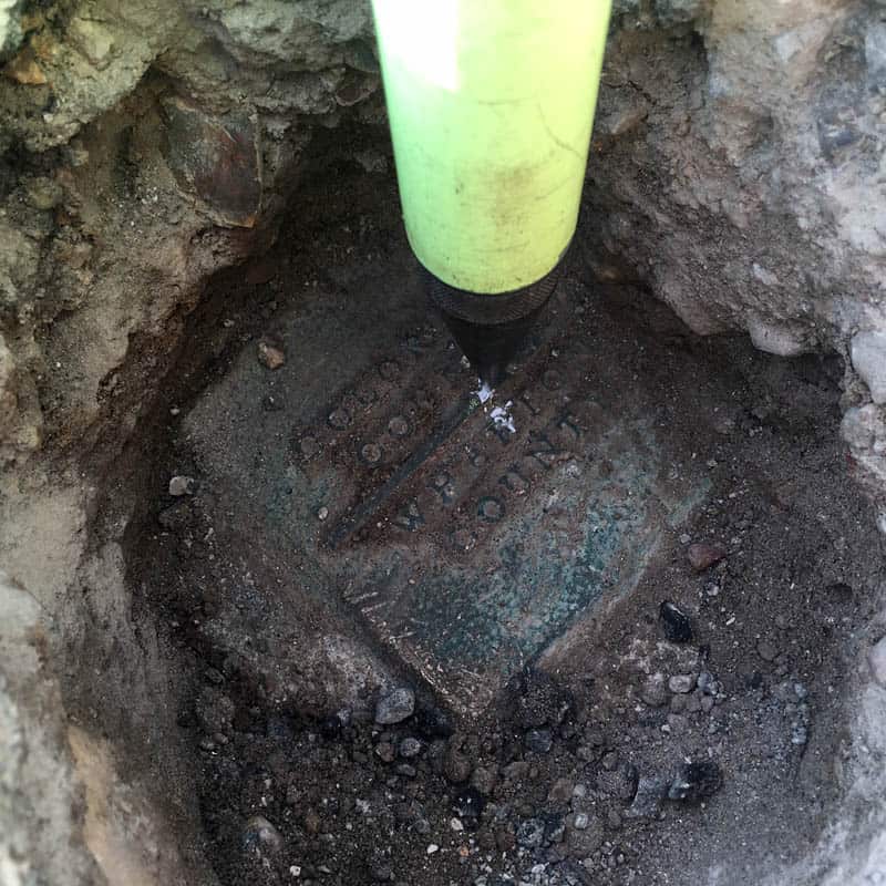

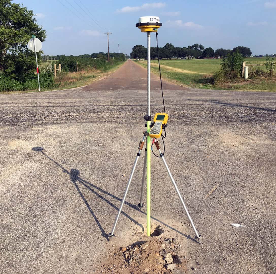

Today was the day when I dug four holes in four locations spread out over about six miles and with mixed results. The success rate was 50% overall, which isn't that bad given the nature of the problem, i.e. sitting in the office, making very good guesses about where old boundary evidence was to be found and then going out into the field to see what, if anything, was actually there.
The spot of white paint on the asphalt pavement was where my initial guess was that I'd find one particular old monument on the county line placed in 1951 by the Wharton County Surveyor and described by him as "an eight inch in diameter concrete post buried in the center of two intersecting public roads". One of the roads that in 1951 had been a fifty-foot wide county road was now a 100-foot wide State Highway, but I had concluded that one line of the present right-of-way was a line of the original right-of-way of the former county road.
A quick sweep with the metal detector provided a correction and then it was me with digging bar chopping through what turned out to be 8 inches of road pavement, a couple of inches of hot-mix asphalt and the rest compacted crushed limestone road base. Unfortunately, the magnetic signature that sounded so definitely centered that I didn't cut a large hole in the road pavement turned out to be misinformation. I ended up cutting a hole the size of a small dinner plate and still missed the center of the monument slightly.
Naturally, this all took place in the hot end of the afternoon when the heat index was around 105?øF. Add in the three folks driving past who stopped to wonder what I was doing, all of whom seemed amazed to know that there was a marker on the county line just outside the windows of their vehicles, and some of whom asked "How did you FIND that?". I told them about the marker nominally six miles away from which I'd calculated the location, and even showed one guy a picture of that more distant marker on my iPhone, which he proceeded to try to take a photo of with his iPhone.
At some point, when the afternoon heat peaked, a cup of cool water on my head sounded better than continuing to chop away at the pavement with the digging bar. Afterwards, as the peak subsided to only 100?øF and falling, the further work that was required to actually uncover the bronze tablet that appears in the next photo seemed both reasonable and even possible.

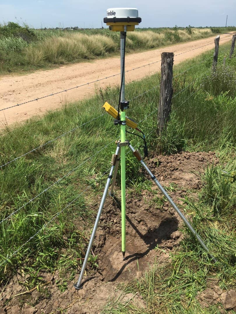

Probably my favorite, though, was the second hole of the day. Would anyone care to guess what this 8-inch dia. patch of lighter soil is into the center of which I set a spike and then located the spike?

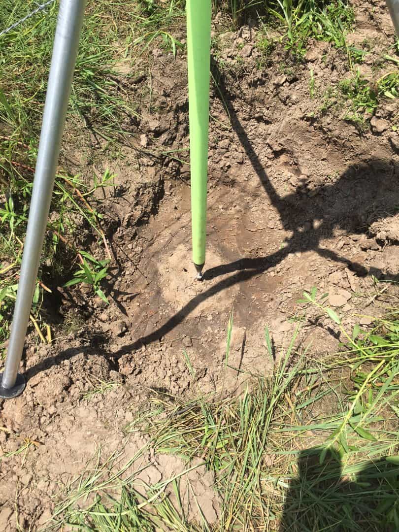

A closer view of the hole that shaving away about 8 inches of topsoil exposed:

Here I'd imagine an old post long rotted, except it'd probably be darker in middle depending on if it's a vegetated area and fair amount of humus.
Do you have authority to digup the roads? What about repair to bitumen surface.
We do here, but there's always that area of rehabilitation which can be a grey area depending on who, where etc.
That's certainly an impressive find.
Common comment before I dig is a scoffing "you'll never find anything there".
Unfortunately the scoffers more often don't hang around to see the results.

Richard, post: 433917, member: 833 wrote: Here I'd imagine an old post long rotted, except it'd probably be darker in middle depending on if it's a vegetated area and fair amount of humus.
That is almost certainly a post hole that has been filled in with a sandy material that differs from the darker silty/sandy soil in which the post had been set. The post was probably removed about eighty years ago, I'd guess.
Do you have authority to digup the roads? What about repair to bitumen surface?
I'd imagine that a person probably could apply for a permit to dig in the road pavement if he had a couple of weeks or months to kill. Normal road maintenance will probably throw a little cold patch in the hole that I backfilled with bits of asphalt on top. Naturally, the engineers who made no provision for a well or other means of accessing the survey marker without actually cutting the pavement would probably prefer that no markers ever be uncovered. Not my problem.

Digging in the middle of the road is always fun. Especially in the heat. Not much fun when you are flagger, digger, and modern day indian spotter all in one. Finding what you are looking for makes it all worth while.

Darryl Beard, post: 433927, member: 11556 wrote: Digging in the middle of the road is always fun. Especially in the heat. Not much fun when you are flagger, digger, and modern day indian spotter all in one. Finding what you are looking for makes it all worth while.
Fortunately for me, that was a fairly lightly trafficked county road that I was working in, the other intersecting county road that had been there in 1951 having been shifted 25 ft. away from the monument when the state upgraded the road to a highway. It was in a rural area and probably more than half the folks driving past stopped to ask what I was looking for.
100% of them were surprised to learn that there was a survey marker indicating exactly where the county line was and most of those also asked "How did you find it?". The question was an interesting one, but in the hot afternoon "It's a long story" was the best I could muster. "The same way that you'd find any other buried treasure," I should have said.

The "soil shadow" is a cool pic Kent.
