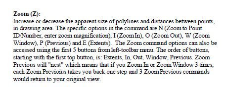

I've been using SurvCE for about 4 years now and have never been able to figure out the zoom-to-point feature of the map screen. I'm hoping that someone smarter than me can point me in the right direction. Here's what the manual has to say about it:

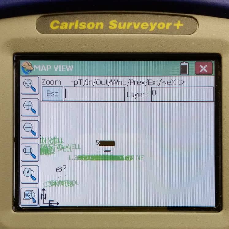

And here's what my map screen looks like:
The command options on the screenshot don't seem to match the manual description. I've tried entering numerous combinations of a minus sign, p, T and point number, without any success. Hints, anyone?

Enter T, then green check, it should then prompt for point id, enter and enter magnification, then green check.

Adam, post: 358631, member: 8900 wrote: Enter T, then green check, it should then prompt for point id, enter and enter magnification, then green check.
Bingo! The "T" thing doesn't make much sense to me, but at least I now know how to do it.

FYI you can tell it's 'T' because that is the letter capitalized in the list of command choices. You will see similar functionality when drawing/editing polylines on the screen. I can't tell from the screen shot if you use field to finish or have linework on your collector, but it can be quite helpful. For example, I will draw the boundary line on the collector screen and then topo the lot. I can check the screen to make sure I filled in the whole boundary. (Good for wooded topo or irregular shaped lot type of stuff).
