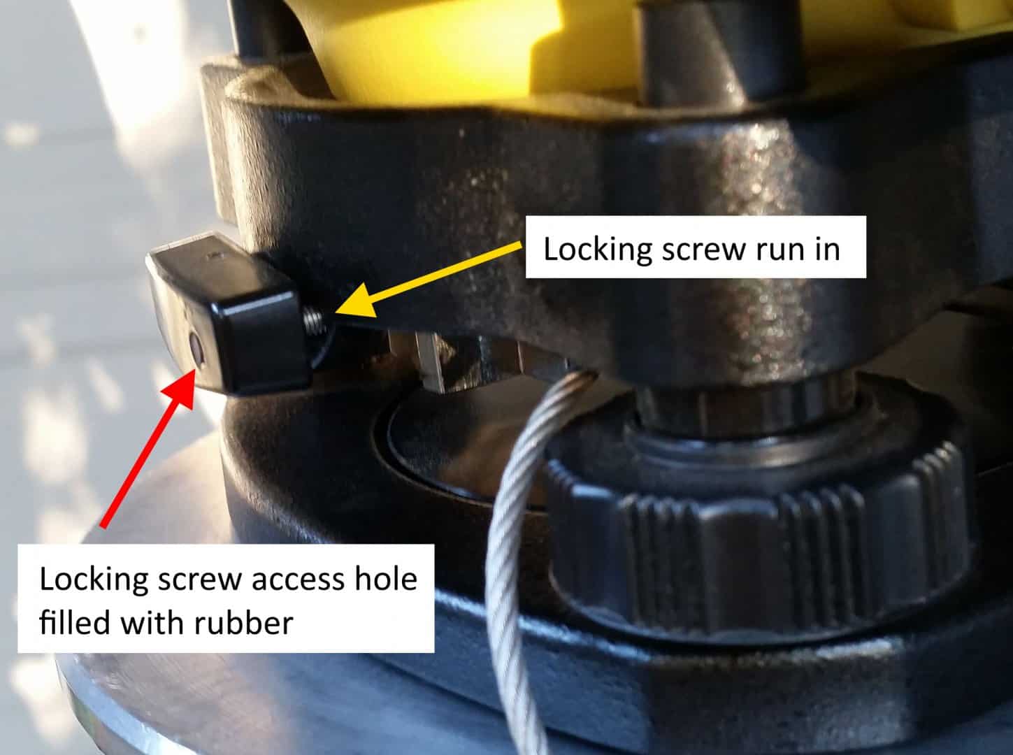

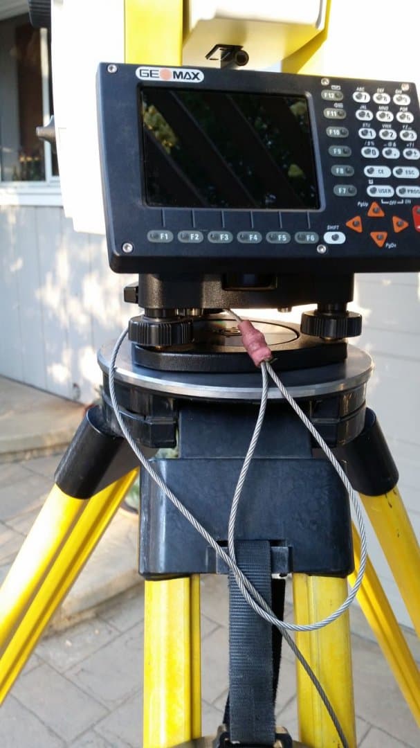

I just loop the cable through the tribrach, between the bottom plate and the instrument base.
Since I don't leapfrog with my robot, I keep the tribrach locking screw run all the way into the locked position, and I filled the access hole with a bit of rubber and cut it off flush. So a thief would first have to pick the rubber out of the hole and then have a small screwdriver handy to back out the locking screw before he could remove the gun from the tribrach.
It's theft deterrence rather than theft prevention, but it's easy enough to do.
