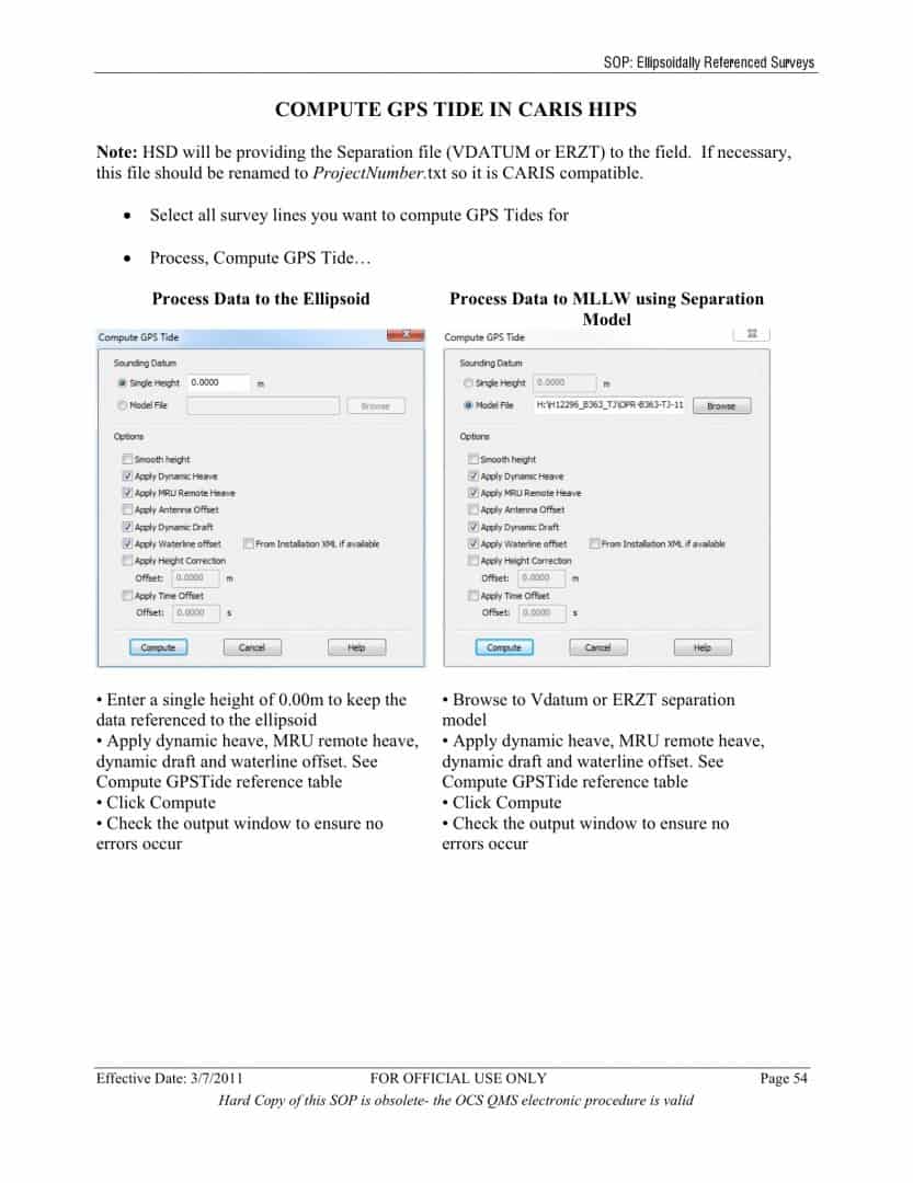

geeoddmike
(@geeoddmike)
Posts: 1556
From:
NOS HYDROGRAPHIC SURVEYS SPECIFICATIONS AND DELIVERABLES
March 2016
USDOC/NOAA
The determination of an ellipsoid height is hardly the only requirement. The referenced document as well as the NOAA Field Operations Manual are available for free download. See: https://www.nauticalcharts.noaa.gov/hsd/fpm/fpm.htm
Posted : March 31, 2017 7:46 am

GeeOddMike, post: 421237, member: 677 wrote: The determination of an ellipsoid height is hardly the only requirement.
Maybe you haven't read entire document. Next time please READ and UNDERSTAND. Those are 2 different things.
The Project Instructions will explicitly list any required subordinate tide gauges. A VDatum or constant separation file to correct soundings from the ellipsoid to chart datum will be provided on the project CD/DVD.
Survey wide data analysis can be performed relative to Ellipsoid or chart datum as most appropriate
4.2.5.1.2 Apply Ellipsoid to Chart Datum Separation Model (SEP) For the 2014 field season, the processes and tools for applying SEP to CARIS processed bathymetry grids are being developed. The process will involve the following basic steps: 1. Ellipsoidally referenced grid surfaces are read from CARIS. 2. Grid math is performed (currently outside of CARIS) to apply the project SEP model (VDATUM or ERZT) datum and datum uncertainty. 3. The adjusted surface data is read back into CARIS now referenced to chart datum (MLLW) with appropriate vertical datum transformation uncertainty applied.
Read read read understand understand understand.
Posted : March 31, 2017 7:06 pm
