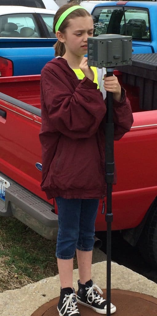

This is a picture of my daughter using the LS as a rover on an ALTA survey last year. It works well at any height.

Not looking up, but level- one of the biggest reasons why I want one. Looking down all day is horrible for you.

I assume those pole locks are secure.
I would be concerned for slippage, slow and imperceptible, with 2.5 kg on top.
This could sound -ve, but not intended. I imagine the developers would be well aware of such an occurrence.
Living off a fixed 2 metre pole it's one concern I never have to worry about.
Apologies - this has got a bit off track from where post started. (sounds a bit like some surveying :-()
Posted : July 14, 2015 4:55 pm

The data collector and receiver are all in one. There is no need to "get above the obstructions". See the picture that I posted earlier in this thread. It was a picture of my daughter using the LS at 4.0' high.
The form factor is very different but after using it, I would not want to go back to a 2 meter pole.

mattsib79, post: 327523, member: 1138 wrote: There is no need to "get above the obstructions"
There are, indeed, situations in which getting the antenna up above things like dense tree canopy or tall ditch banks is necessary in order to receive clean (or any!) data. Where I work these situations aren't common, but I've certainly run into them. I think the RAMS solution would be pretty workable, but I need to try it out to see how well it works.
