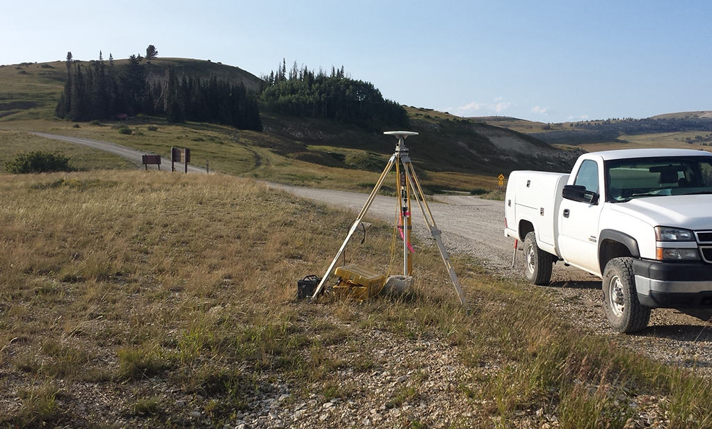

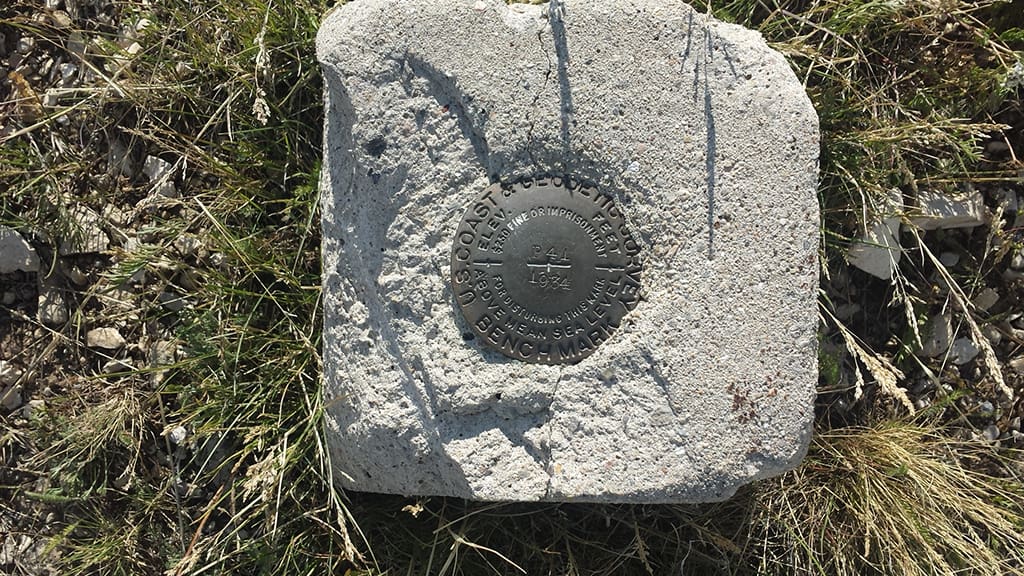

On my Tunnel Project I ran a GPS session on a Benchmark in the middle of the project. I got 0.082 meters difference. GEOID12B quite OK, eh?
Here is the OPUS return and the Datasheet. I highlighted the ortho height in each. This is on the top of the mountain.

Considering the limited number of GPS on bench marks in the NGS database that contributed to GEOID12A (or any other previous model for that matter) 8 cm doesn't seem bad at all. I am led to believe that NGS is planning a new geoid model for sometime in 2016. If anyone wants the model to improve in their area then they will need to either submit GPS on 1st- or 2nd-Order NAVD 88 bench marks as a Blue-Book project or using OPUS Share Solutions (much easier). If the number of GPS on BMs obs don't increase then don't expect any improvements until the new vertical datum planned for 2022. If the number of GPS on BMs don't increase in most of the western states than the vertical transformation tool that NGS will create will most likely be much less reliable as well.

That datasheet only has a second order elevation derived from leveling... no GPS coordinates, no NAD83 ellipsoid height, nothing. I agree with David, 8cm seems pretty darn good to me, especially in the mountains.

iUsing the relationship h - H - N = 0 and your h and the published H we get a geoid-ellipsoid separation of 16.305 m. The modeled value is 16.39. Assuming there is no problem with your HI this difference looks large. Unfortunately geoid models do not perform well in high mountain areas. Further, there are issues with respect to the determination of orthometric heights from the field-determined leveling differences. Orthometric heights take the field values and incorporate gravity data to convert them to geopotential differences. Until we get the good gravity values from GRAV-D I imagine the values in the NGS database are poorly geo-referenced and of problematic quality.
I note that the orthometric height was determined in the 1930s. Lots of possible geophysical deformation since then.
While I agree that GPS observations on NGS-published benchmarks will help improve the hybrid geoid model, there needs to be better and more current gravity and better theory to deal with issues of mass densities and the downward continuation in mountainous areas. These factors impact the gravimetric model on which the hybrid model is based.
Unfortunately, without access to additional information not on the datasheet I cannot evaluate how the 1934 observed heights were updated to NAVD 88 benchmark.
A search for projects associated with this PID results in only the original level project: L1817. This means no additional observations have been made on this point since the 1930s.

Posts: 2701
Dave Karoly, post: 331468, member: 94 wrote: Is the U.S. Bureau of Public Roads sign still there?
Original sign is not there, probably gone due to road improvement.
Here are the Pictures.
Posted : August 12, 2015 1:11 pm

geeoddmike
(@geeoddmike)
Posts: 1556
Your picture of the monument shows it has been damaged with the left side showing significant damage and a crack on the top and bottom of the disk. The disk is not centered in the remaining post.
As there is no way to determine whether it was displaced, as its previous position was by scaling, I would consider myself lucky getting an eight centimeter agreement with the GPS-derived value.
As for extending levels to one other BM, if your results do not agree within expectations what do you prove. The only way to resolve the issue would be extensive leveling. No one is going to pay for that.
All hail the new vertical datum based on GPS-derived ellipsoid heights and a high resolution geoid model.
Posted : August 12, 2015 1:50 pm
ridge
(@ridge)
Posts: 2701
GeeOddMike, post: 331548, member: 677 wrote: Your picture of the monument shows it has been damaged with the left side showing significant damage and a crack on the top and bottom of the disk. The disk is not centered in the remaining post.
Could have been hit or it could just be weathering. I've seen some a lot worse than this that I know haven't been hit. I went and found PP41 and it was in pristine condition in a grove of Aspen trees (Not GPSable). The next one is N41 which I didn't have the data on at the time to search for. It is in a rock outcrop so probably a good one. I used P41 also as a RTK base point to hunt for some section corners for my project. So I just left it over night and got the OPUS data and was glad it was still there in the morning being right on the road like that. We all like to do this sort of stuff but it's hard to get paid to to it.
Posted : August 12, 2015 2:14 pm
Posts: 10008
The disk appears to still be embedded in the concrete, so the only concern is whether the concrete post is leaning or broken off near ground level, and it doesn't appear that it is.
Posted : August 12, 2015 4:22 pm
geeoddmike
(@geeoddmike)
Posts: 1556
Not to re-irritate the issue, I still feel that the monument shows signs of damage which could have impacted its height. There have been eighty years since the work was done.
Unfortunately, NGS policies on accepting level data requires that work done to replace, update or verify the published values require that second-order leveling be performed and all the associated paperwork. Not likely in this or many similar cases.
Getting back to the point of my earliest response, I still think there are issues with the determination of orthometric heights at these high elevations. Prof W. Featherstone of Curtin University in Australia has a very interesting paper on his web page on this issue. It is here: http://espace.library.curtin.edu.au/R?func=dbin-jump-full&local_base=gen01-era02&object_id=158292
I also point out the difficulty of geoid modeling in these high mountainous areas. As you mention there are large geoid slopes. Gravity reductions given lateral mass density variations and the like remain problematic.
Enjoy the paper. I especially recommend looking at his other papers. Looks of good stuff and clearly written as well.
