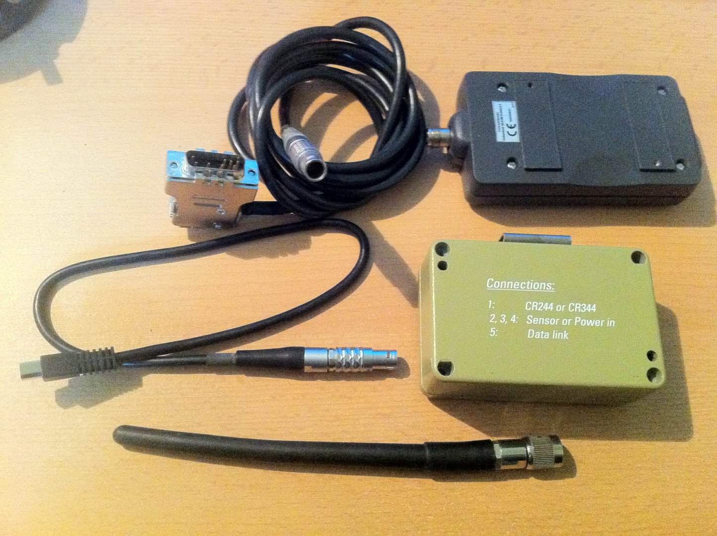

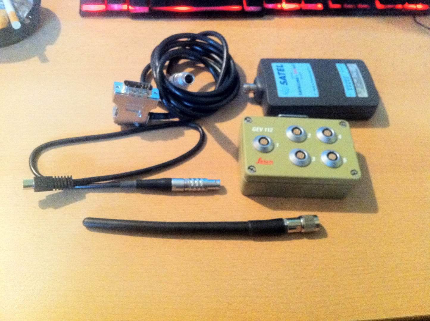

I have two radio modem satel 2asm2 and leica 1230 receiver.
Need help, setup modem.
Best regards,dragan

I upload image,

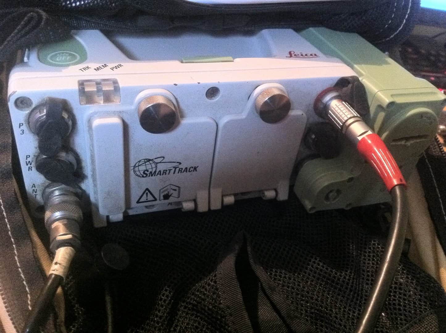

Inspired from your tutorial i build my low cost NTRIP Box for my Leica SR530 that uses power from Receiver and has its own short range bluetooth for my Smartphone. With the additional 9 Pin D-Sub Connector you can also stream NMEA data from SR530 over bluetooth to the smartphone.
I used this Parts:
5V Mini Usb RS232 Bluetooth Serial Adapter Master-Slave ~9$?ÿ?ÿ runs with 5 volt, with two-way bluetooth communication
3A DC-DC STEP DOWN BUCK CONVERTER 8-22V TO 1-15V?ÿ?ÿ ~14$
case with cap ~2$
maye one of these or you got some jst connector with pin distance from 1.0 mm to 1.5mm, dont know excatly
JST 1.25mm 2-Pin Micro Female ~3$ ?ÿ?ÿ
Lemo Connector to connect to GPS500 like written May 16, 2017 6:21 am from Micheal D'Aubyn.
Maybe cutting some existing Lemo cable with 5 pin (FGG.1B.305) or 8-pin (FGA.1B.308).?ÿ?ÿ ~30$
Heat Shrink Wire ~6$
Soldering gun.
The chinese bluetooth module needs 5 volt so i need the step down converter to convert the 12V from the receiver (red + black cable).
Also the RX TX connector at the bluetooth module did not work correct, so i had to solder directly to Pin 2 and 3 at the 9-pin connector (thin yellow + white cable).
Like written here the bluetooth module is also equipped to charge over mini usb, when used with 3.7V 1400 mAh Li-Po battery, but i did not use:
http://dev.lab427.net/bluetooth-serial-console.html
I used the battery connector with JST 1.0mm (little to small) to supply with 5 volt from step down converter (yellow+ black cable). Maybe could have used VDD and GND soldering connector for 5 volt input but i choose this way.
Some cutting / drilling / soldering later it was finished and ready to connect to the NTRIP client app from Lance Lefebure (version 2018.01.14). Big thanks to Lance!
Thanks to Micheal D'Aubyn for inspiration and maybe this will help someone.
