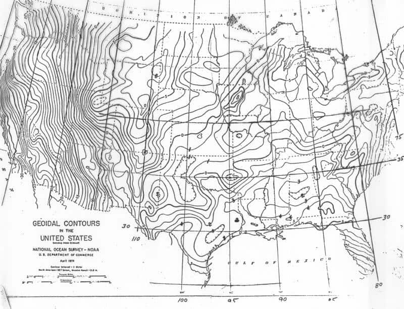

The current Wikipedia entry https://en.wikipedia.org/wiki/Geodetic_datum&apos ;">Geodetic Datum has a statement in a paragraph discussing NAD27: "The geoidal height at Meades Ranch was assumed to be zero."
At first glance this makes no sense to me. I thought the horizontal datum was on the mathematical ellipsoid and would have no relationship to the geoid. Is there some small second order effect that causes an interaction of the vertical with NAD27 (or NAD83 either) that would need such an assumption at the time?
I didn't find a data sheet for Meades Ranch, but look at the data sheet for KG0640 Meades Ranch Reset (http://www.ngs.noaa.gov/cgi-bin/ds_mark.prl?PidBox=kg0640&apos ;">NGS) (https://www.geocaching.com/mark/details.aspx?PID=KG0640&apos ;">Geocaching has older https://www.geocaching.com/mark/datasheet.aspx?PID=KG0640&apos ;">data sheet) and note the NGVD29 elevation is within a meter of NAVD88, and the current geoid separation is more than 26 meters.
Should that Wikipedia statement be deleted?

No, that is a true statement. They did not know accurately what geoid heights were. They picked an earth radius (clarke1866 ellipsoid) and then made the separation=0 at the origin. This meant that reducing a distance to the ellipsoid=reducing the distance to "sea level". As the network went away from the origin, this introduced a systematic bias in the distances, especially going west (larger differences). They also set astro lat/long=geodetic lat/long, which meant that the slope of the geoid at that point was also set to zero.
Once the space age came around, they were able to model the separations. Here is a (relatively unknown) map prepared by NOS in 1974 of the NAD27 geoidal separations:
Posted : November 9, 2016 9:04 am

So they could define the ellipsoid and horizontal datum origin, but to compute the horizontal position of anyplace else they needed to relate the measured distances back to the ellipsoid, and thus needed to know the elevation of those places in relation to the origin. I think I've got it.
As an aside, I also find the map you posted interesting in that it shows a serious anomaly in NW Iowa, which I believe coincides with the https://en.wikipedia.org/wiki/Manson_crater&apos ;">Manson meteor impact.

That map is pretty crude, but I think it shows why they chose Iowa as the second location for the geoidal profile done last year.
In order to properly reduce distances to the ellipsoid, they needed to know "where it was". So they just assumed it was equal to sea level (i.e. NGVD29=0). As I said, this created a rather large bias in distances as you went west, less so to the east, about 1 ppm per 6 m of separation. So 5-6 ppm in California, just about 1 ppm on the east coast, 2 ppm in S Florida. One of the several reasons for doing the NAD83 adjustment, they then knew where the geoid was a lot better, not nearly as well as now but well enough to minimize distance distortions.
