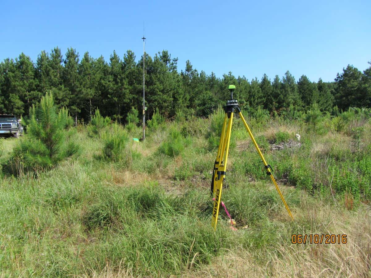

I drove the the job, and turned on the LS, and told it to STAKE the other surveyors base. It took me to within 5 ft of it. Mr Shonestedt jumped on it, like a goose on a fat frog. So, since it was a pretty good place to set a base, I set it there.
Here is my base set and running.

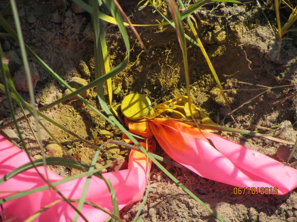

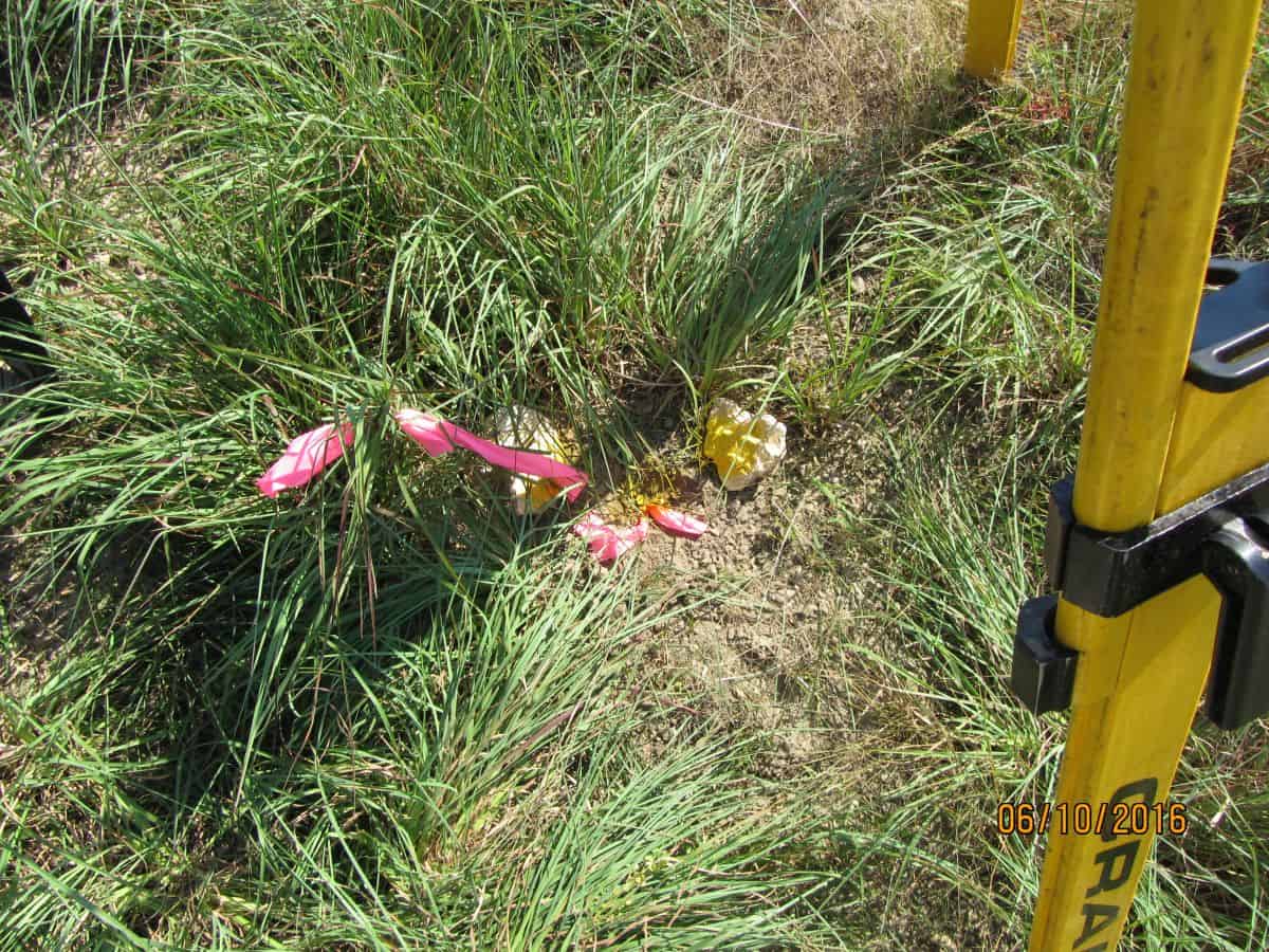

Here is the nail, I found, as the base, set by the other surveyor.

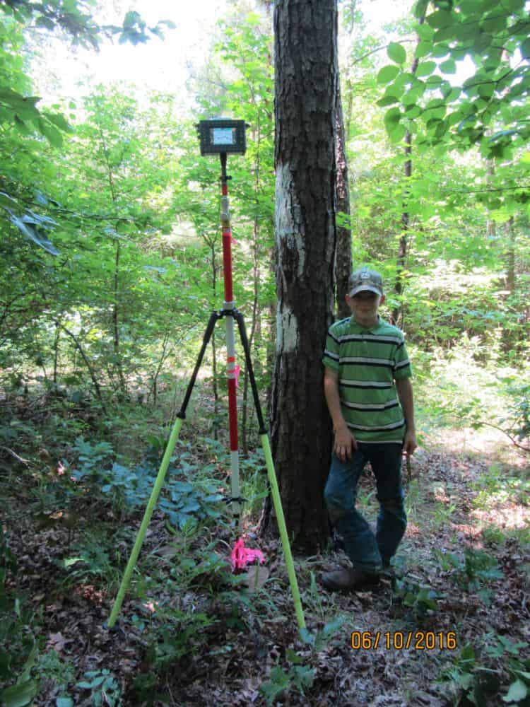

Then, I went and shot a number of corners.

I will add, there was a small piece of faded flagging, on that nail, out in the middle of a clear-cut, that had been replanted with small pines. It would have been totally impossible to find that nail, without staking it. I staked it WITHOUT a base, and without corrections. We don't have any kind of rtn here. The autonomous solution took me to the nail. I wthink it is semi-corrected with something.
