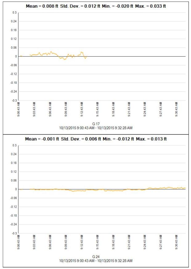

Bear in mind that the reflections are transient -- as each SV moves along its orbit, the reflected signals will vary in strength from zero to a not-very-strong peak and back to zero. By collecting data over a period that's a significant multiple of the multipath duration, the inaccurate range values get overwhelmed by good data. That condition is at the heart of static positioning.
Even in a wide-open spot with no multipath reflectors, some data is cleaner than others. The two graphs below are from a half-hour session. The data from SV24 is super clean, while the data from SV17 is dirty by comparison. But the solution for SV17 is pretty good nonetheless because I had about 13 minutes of data over which to average out the solution. The same is true with modest multipath situations; with crazy multipath conditions, all bets are off.
Posted : December 8, 2015 11:16 pm
