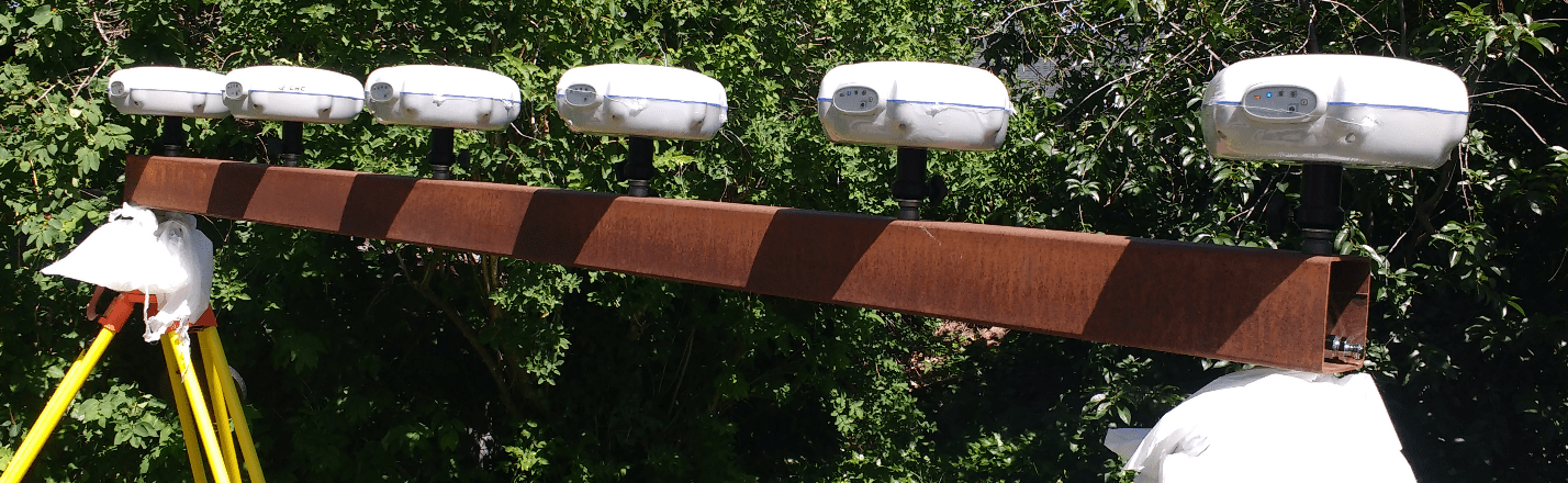

I've tested a lot of receivers within a foot of each other. I've never seen any issues from interference.
A traffic control cabinet I'm sure is producing some interference from the high voltage that must be running through it. A GNSS receiver wouldn't have nearly that sort of issue.

I'll take your five and raise you one.

So, six high precision Chinese receivers go to a bar and...
Posted : November 18, 2016 5:38 pm
Shawn Billings, post: 400286, member: 6521 wrote: So, six high precision Chinese receivers go to a bar and...
Order Guinness and a shot of Jameson...
:dizzy:
