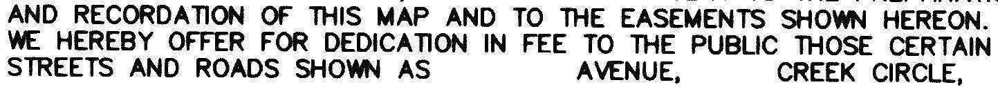

The title sheet with dedication.
031mr085 Title Sheet.pdf (661.8 KB)

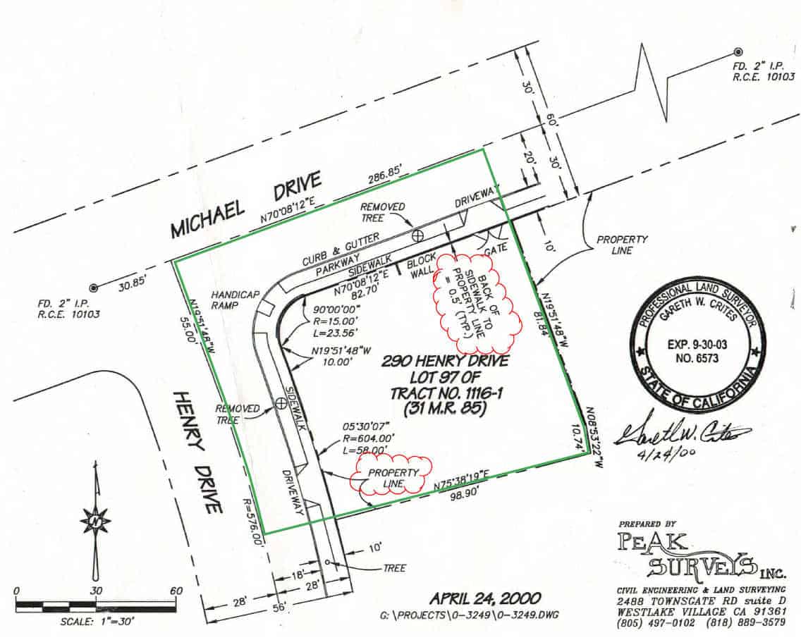

BajaOR, post: 402731, member: 9139 wrote: Well, I'll think twice before I ever label a street easement line as "property line"....
(coloring is mine).
That is my property, correct. That is the land surveyor map that I paid to show my property line. My property line goes out 6" before the sidewalk. Your green line goes out to the middle of the street. Can I assume that this green line represents the easement, from both the County and Utilities. The easement is an automatic easement, when the dedication of property is approved. Easements don't define property, Land surveyor map dimensions define my property, when it starts and when it ends. That is my personal property, in my deed. I'm responsible for this property, as a private property owner, pay property taxes till the end of the property, as per the County. What am I missing?
Posted : December 6, 2016 5:16 pm

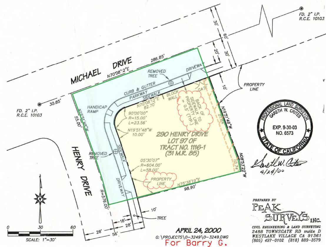

Barry G, post: 402743, member: 12296 wrote: That is my property, correct. That is the land surveyor map that I paid to show my property line. My property line goes out 6" before the sidewalk. Your green line goes out to the middle of the street. Can I assume that this green line represents the easement, from both the County and Utilities. The easement is an automatic easement, when the dedication of property is approved. Easements don't define property, Land surveyor map dimensions define my property, when it starts and when it ends. That is my personal property, in my deed. I'm responsible for this property, as a private property owner, pay property taxes till the end of the property, as per the County. What am I missing?
The green line represents your entire fee ownership, as has been stated multiple times. Your surveyor, in my opinion, mislabeled the edge of the county road easement as being the "property line". To the lay person, who wants to build a fence along his side property lines and wants to know where to stop building, it might get called the "property line", but it is not (for you or for the county). It's the right of way line, easement line, edge of street/easement, edge of public rights, ....etc. As has been stated several times, the extent of your ownership doesn't really matter in any of this because unless the county vacates/abandons the street easement, you can't do much of anything with the part of your property overlaid/encumbered by those public rights.

I think Warren's introduction of "feasible" and "indefeasible" might have confused things for you and your situation. I don't usually deal with those terms, though I understand that indefeasible is your normal, everyday fee title, aka fee simple, aka fee simple absolute. Defeasible fee "may be defeated on the happening of an event" (Black's). Someone above may have used the example of a dedication of fee street rights that revert if not used as a street. I'm not going to ponder that because it's not pertinent to your situation. In your case the county never held or gained any kind of fee title. They hold only an easement for the benefit of the public. Remember that fee = ownership = control (subject to encumbrances). Easement = a right to do a specific thing on your property.
You said "However, the fee simple itself can be subjected to various conditions and/or contingencies". Conditions yes, contigencies not so much. Ownership of fee simple is absolute, but the property can be subject to conditions (encumbrances) such as easements, tax obligations, zoning, etc. The only contingencies I can think of are not paying your taxes, mortgage, etc, which is not what I think you had in mind.
I hope I haven't confused matters. Here's a different map that might help the discussion.
Posted : December 6, 2016 8:21 pm
