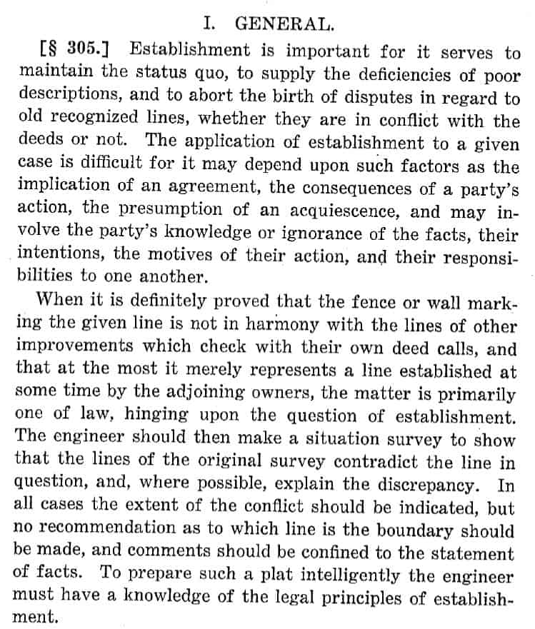

Here is a scan from Skelton's Boundaries and Adjacent Properties on the Establishment of Boundaries. He seems to have the same cautionary stance as Brown/Robillard. He even goes so far as to recommend not to commit to a boundary line until the difference is resolved.
Posted : September 20, 2015 7:47 pm

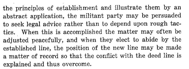

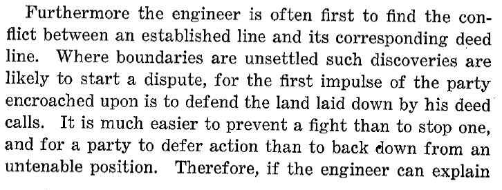

Skelton goes on with a recommended course of action in these cases:
Posted : September 20, 2015 7:52 pm
