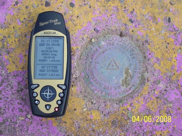

There was an NGS survey done around here in 1975 that put new triangulation stations on hilltops where there was already a USGS station. This happened in various locations...sometimes they kept the same name as the USGS mark as well, which of course confused everyone.?ÿ
A similar situation exists at a triangulation station near my office...see KY3089 and KY3090. These are not on the same hill, but are about 0.6 miles apart, both with the same name, one set in 1900 by USGS and the other set in 1927 by USCGS. The USCGS mark has an interesting recovery note from 2008, where the person was saying that based on a handheld GPS coordinate the station "should be moved back to its original position:
 KY3089                          STATION RECOVERY (2008)
 KY3089
 KY3089'RECOVERY NOTE BY INDIVIDUAL CONTRIBUTORS 2008 (DH)
 KY3089'NGS REPORTED COORDINATES N 40 DEG 21.216 W 080 DEG 00.990 (NAD 83)
 KY3089'ARE INCORRECT.
 KY3089'THE ACTUAL COORDINATES ARE N 40 DEG 21.219 W 080 DEG 00.994 (NAD 83)
 KY3089'SEE TINYURL.COM/6KNOTQ FOR PHOTO SHOWING THE INACCURACY.
 KY3089'THE BENCHMARK POSITION HAS CHANGED.
 KY3089'IN THE DOCUMENTED HISTORY 25-JAN-1989, 'HIT BY MACHINERY AND PART OF
 KY3089'THE DISC HAS BEEN SHEARED OFF. THE MARK MAY BE SLIGHTLY OUT OF
 KY3089'POSITION'
 KY3089'PLEASE EITHER UPDATE THE COORDINATES OR MOVE THE BENCHMARK BACK TO THE
 KY3089'CORRECT LOCATION.
Here is the photo they reference in the description above...

While the recovery note another amusing example of persons performing recoveries oblivious to the plain reading of the description. I wonder how this individual reconciled what he was looking at and the statement that ƒ??...part of the disk is missing...ƒ? and the name of the organization on the disk?
