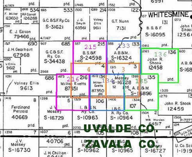

This is a slightly unusual land surveying project that I worked on a couple of years ago that has some features that are probably unique to Texas surveying. The work consisted entirely of research without ever setting foot on the land involved.
The diagram below shows shows the situation reasonably well. The claim was being made by the State of Texas that a couple of hundred acres of Survey 215 (in magenta) were actually owned by the State by reason of being a part of Survey 4 (in orange) that had supposedly been appropriated for the Permanent School Fund by virtue of a survey made prior to that which located Survey 215.
The net result of the State's claim was that if the facts were as alleged, the landowner who had the area of conflict enclosed within his fences and whose predecessors had been using it at least since 1895 as if they were the land's rightful owners would need to write a large enough check to buy the roughly 200 acres of land from the Permanent School Fund of the State of Texas.
Considering that the surveys in question were made in 1876, this was a situation that had existed for about 137 years. During that time, it turned out that different regimes at the GLO had even formed differing opinions about the status of the conflict.
After reviewing the GLO patent files, reading the various pieces of correspondence that had passed between the GLO and interested parties, and examining it all in the light of the statues in force at various times, I wrote it all up as a report that I thought would lead a person to the same conclusion that I had reached, which in fact it did. The State withdrew its claim.
In case anyone is interested in how far into the weeds of history some of these surveying projects can get in Texas, I've attached a copy of the report with a name or two redacted.
