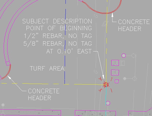

Kent,
Here is my adventure this morning:
(a) He did not add his tag, as required. That is mandatory, not an option.
(b) His not adding his tag is a moot point because there are in fact three iron rebars there, not two, all of them tagged with well known numbers, and the oldest is right where I thought it should be.
(c) Amazing what a shovel can turn up if you actually dig in the ground, and then carefully scrape away the dirt around the iron rebars to find the tags.

Three rebars, all with tags, is impressive. Is the idea that some surveyors don't use stainless steel wire to attach the tag and the wire just rusts away so that the less-than-diligent practitioner can claim not to find the tags?
