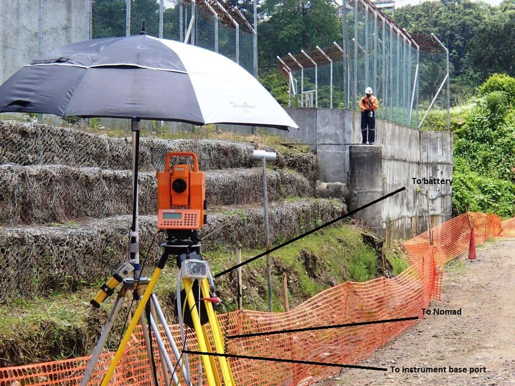

Mark O. You need the T-connector as shown in the photo (mine looks red because I have taped it permanently to one of the cables to minimise the risk of loosing the T, as it smaller than an AA battery) so that power and data is only connected at the instrument base port. If you connect the Nomad to the keyboard it wont work, and also if the robot spins you'll be in trouble with the cable.
In the photo, my config is actually running through the radios, so instead of the Nomad cable connection to the T, there is radio connected to it and this sends/receives data to the other radio which is wire connected to the Nomad. The radio at the T gets power (stepped down to 5V) from the 12V external (car) battery that runs the instrument, and the radio at the Nomad has its own 5V battery so it does not draw power off the Nomad.
