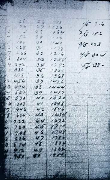

I was looking through a copy of a field book kept in 1887 by a Texas surveyor named J.L. Long in the course of an extensive amount of resurvey work he carried out near the edge of Oklahoma. Mr. Long and others were set to the task of actually figuring out where hundreds of nominally mile-square sections had been located across an expanse of prairie in 1867, but mostly on paper. By 1887, there was a pressing need to actually determine where the sections were, roughly half of which had already been patented and the other half the alternate sections that the State of Texas hoped to sell to fund schools.
There among the notes of Mr. Long's hundreds of miles of traverse, two miles to a page, was something that that I don't recall ever having seen before, but which may represent a common practice of the day. The clue is this handwritten table:
The top rows read:
[PRE]1 38 26 988
2 76 27 1026
3 114 28 1064
4 152 29 1102[/PRE]
What do you suppose one might reasonably deduce from the above table?

He wanted a quick reference for measuring in varas using a 100' chain?
Posted : May 11, 2017 5:47 pm
flyin solo, post: 427908, member: 8089 wrote: He wanted a quick reference for measuring in varas using a 100' chain?
Except 36 varas = 100 ft. 38 varas = 105.56 ft., So his chain was 105.56 ft. long.
Posted : May 11, 2017 5:49 pm
flyin-solo
(@flyin-solo)
Posts: 1676
Right. Best I could come up with in lightning round mode.
5280/1900= 2.778
So a 1/50th mile chain?
Posted : May 11, 2017 5:50 pm
We can rule out the Fibonacci numbers...
Posted : May 11, 2017 5:51 pm
flyin solo, post: 427910, member: 8089 wrote: So a 1/50th mile chain?
Yes, that's what the table describes. Next question is exactly what sort of a thing that chain really was.
He was surveying on the North Texas prairie, but the chaining notes in his field book indicate 200 vara "outs".

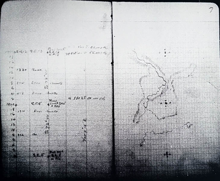

Here's a typical page from that 1887 field book as an example. Note that the fieldbook reads from bottom to top:
Posted : May 11, 2017 7:00 pm

Okay he reaches the corner of a survey to connect to and he's fifty varas, chains, or feet out; and the table is his correction line to run back, which just happens to work out to thirty-eight varas, chains, or feet of run

How do you imagine that his table would be useful to facilitate that?
Note that the passing calls in the typical field book entry I posted abover generally occur at 38 vara multiples.
Posted : May 11, 2017 7:10 pm

The problem with that theory is that the 1887 surveyor was running as far as 13 miles or more before closing and these are the passing calls he noted on the typical page above:
[PRE]1900 (= 50 x 38) Post & 4 Pits
1330 (= 35 x 38) Road
874 (= 23 x 38) Edge Brakes
418 (= 11 x 38) Edge Brakes
1710 (= 45 x 38) Edge Brakes
836 (= 22 x 38) Pass something
0[/PRE]
Posted : May 11, 2017 7:28 pm
I'm not sure how that matches his even number stations on the left margin.
Posted : May 11, 2017 8:08 pm
R.J. Schneider, post: 427935, member: 409 wrote: I'm not sure how that matches his even number stations on the left margin.
The 200 vara stations are most likely just for form, presenting the notes as if he had actually been measuring distances with the 20 vara chain. It's pretty obvious that he was really running a 38 vara chain. My guess is that it was custom-made out of a length of steel wire and wasn't really even a surveyor's chain at all.
If you consider the 1887 surveyor's reason for also tabulating the lengths of different 1/5 multiples of the chain, i.e.:
[PRE]1/5 7.6
2/5 15.2
3/5 22.8
4/5 30.4
5/5 38[/PRE]
That doesn't even suggest a fully graduated tape or chain, but would be consistent with a wire. Presumably any additional intervals smaller than 7.5 varas (about 20.8 ft.) were paced.
Posted : May 11, 2017 8:58 pm
Just for color, here's a note entered in the field book that gives some idea of the comforts of surveying on the prairie:
Friday Eve, February 26th, 1887
At night came very strong wind - blew tent down making several large rents - which could not be taken up - party all out in the cold.
One of the section corners that the party marked was described as "Two Buffalo Heads in a Valley", which would have been years after the buffalo herds were hunted to near extinction.
Posted : May 11, 2017 9:14 pm
